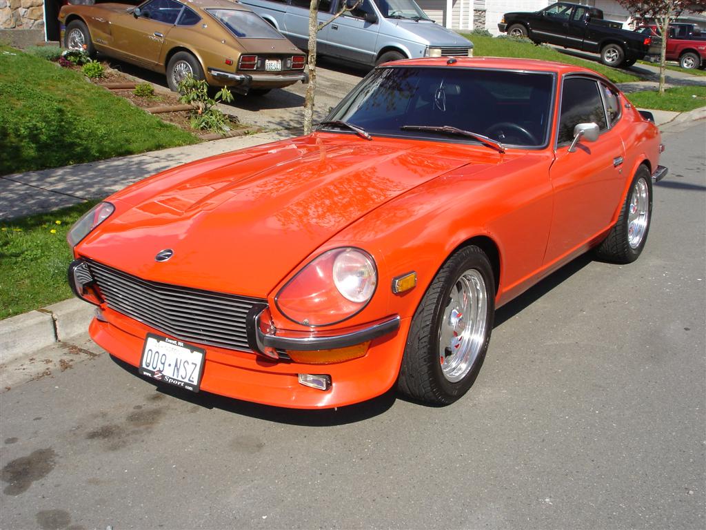

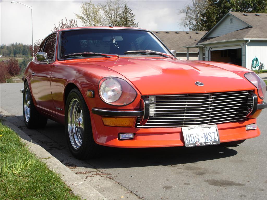

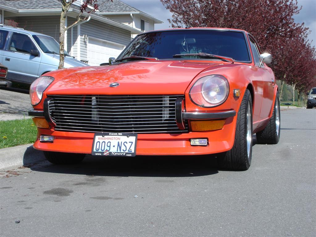

It should be very similar to the 260Z stance. I have KYB struts and Eibach PR springs and here's what it looks like. Also, I have 225/50ZR16's if that helps.
Dave.
