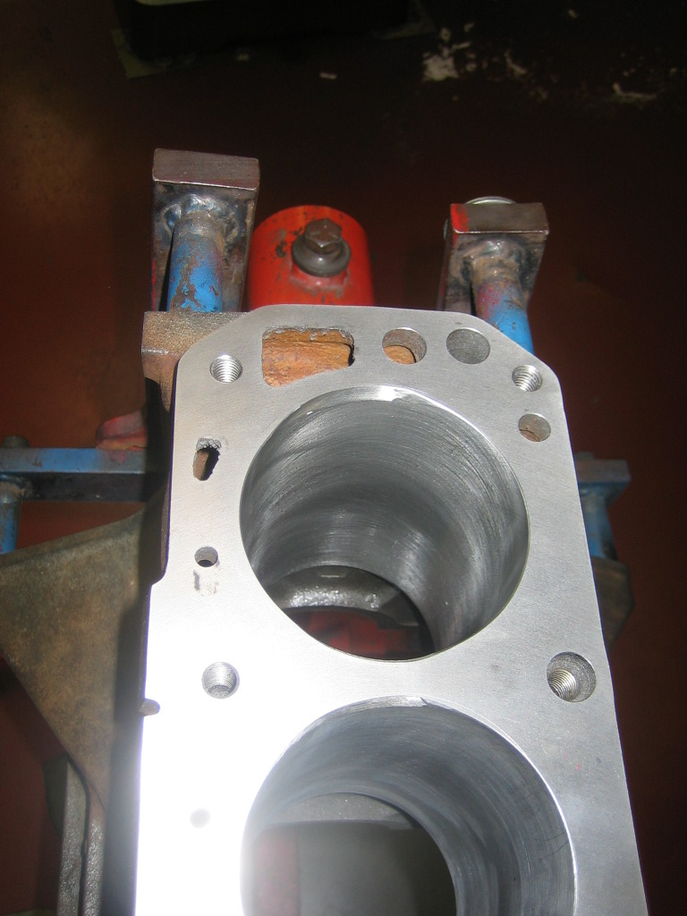

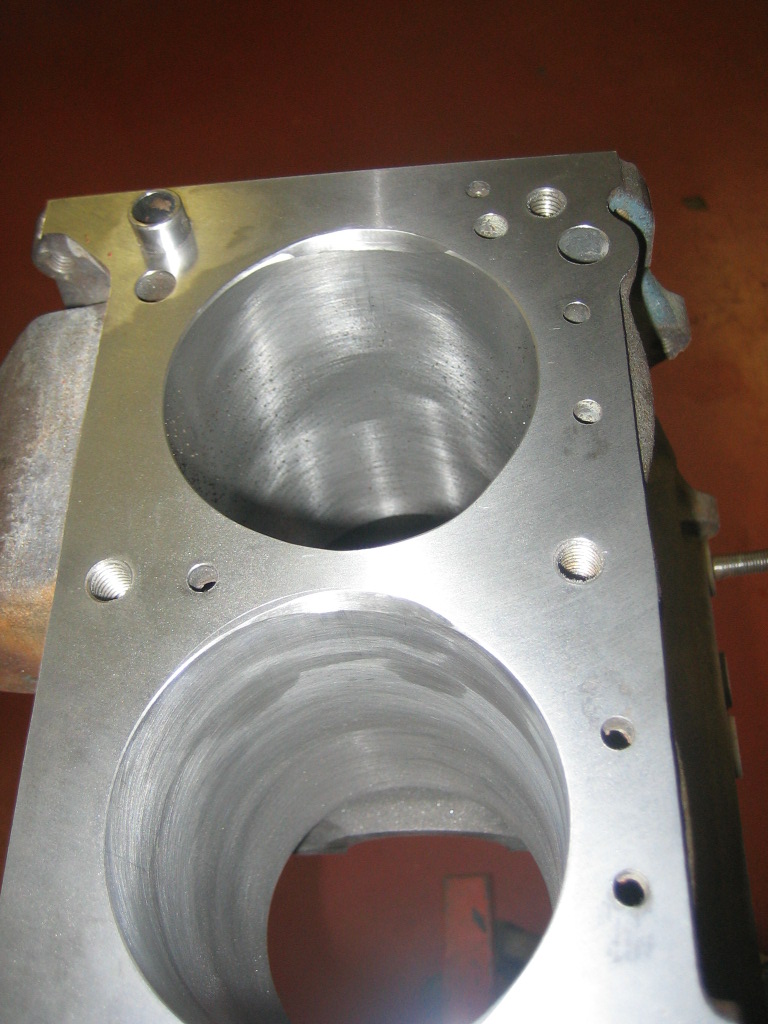

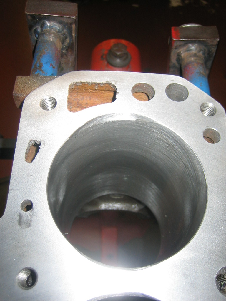

Basically, the N42 has larger valves than the E31/E88 of the 240Z. Since the N42 was introduced on the larger bore 2.8L of the 280Z, there's no interference with the block when the valves open for the exhaust stroke.
If you are running a smaller bore 2.4L (which sounds like you are), the valve will make contact with the block on the exhaust stroke of the cycle, which can cause damage.
Can't say this is the primary cause of your problem, but I'll bet it's contributing to it.
Look very closely at madkaw's pics and you can see the "eyebrow". It the chamfered edge of the piston bores to allow valve clearance.
