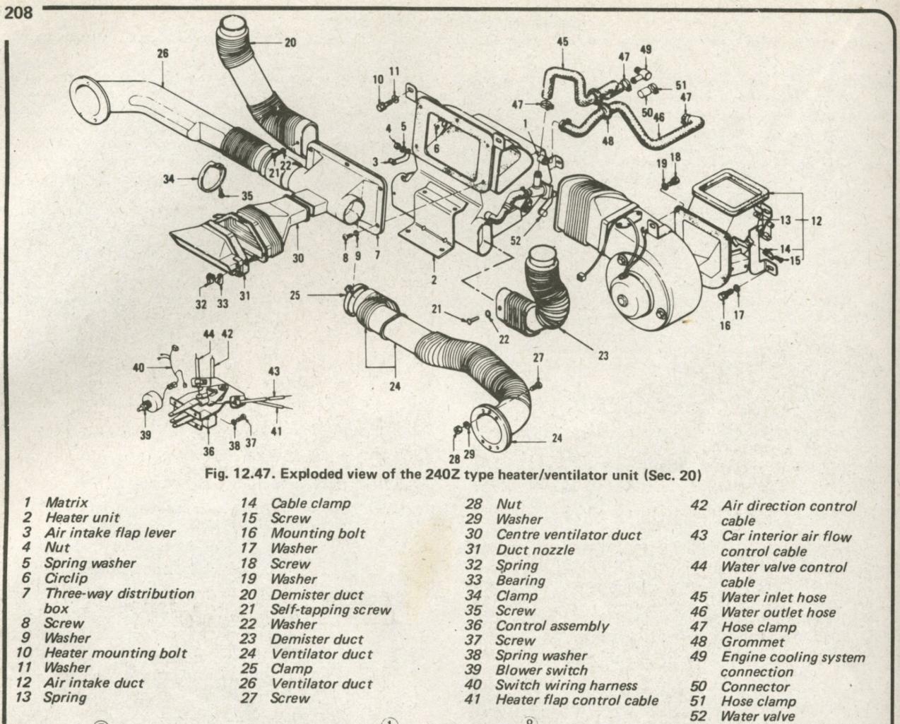

The illustration in the Nissan parts manual is the same as Graeme posted. It doesn't show the cables or any "hangars". The associated parts number listings does not show any thing that could be described as a hangar or used to hold the cables in place either. Hopefully you only need to route the cables properly and fasten them. Take notes when you get it right in case I run into trouble putting mine back together.:eek: Seems to me I read a very old post covering this. Got you covered with the cable clamps & screws. PM me a mailing address and I'll try to get them to you before a Canada Post strike happens.
