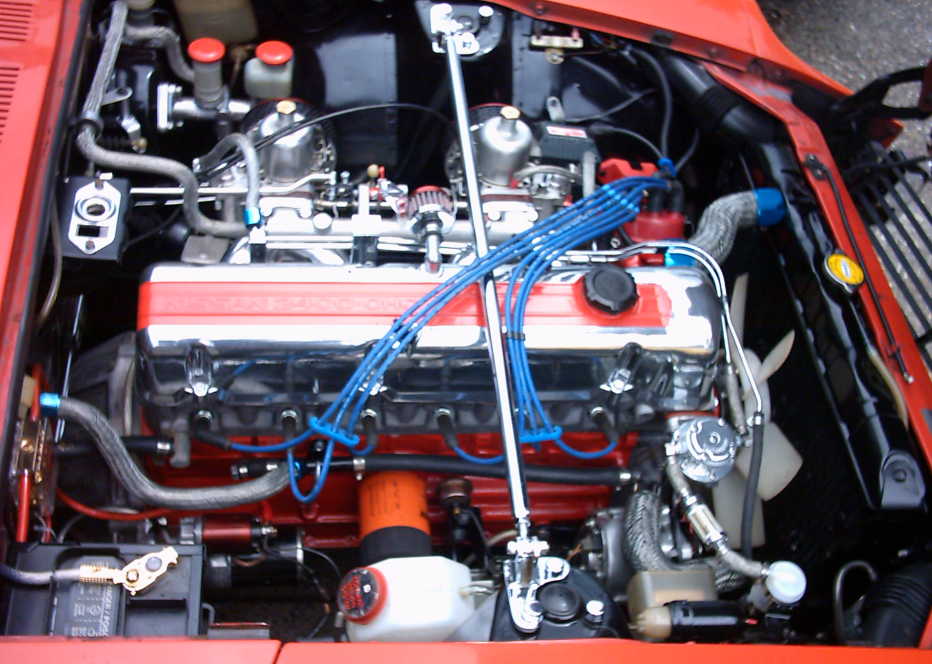

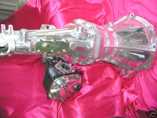

I guess it all comes down to what extant you're willing to go to make it look decent or fricken awesome. Take this for example......

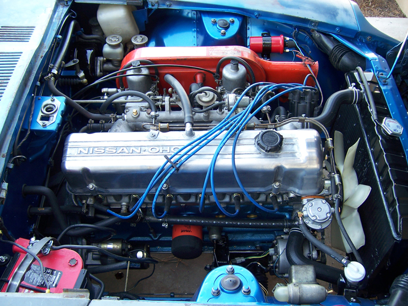

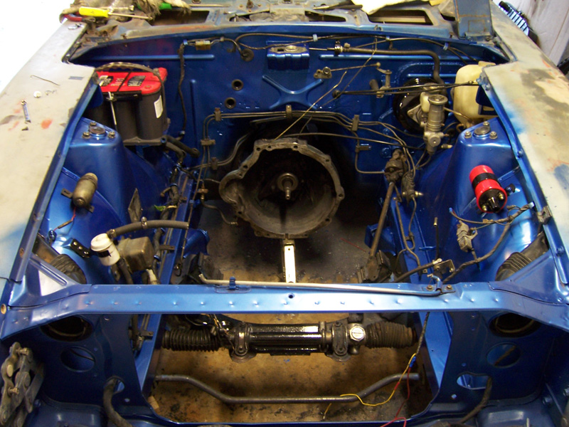

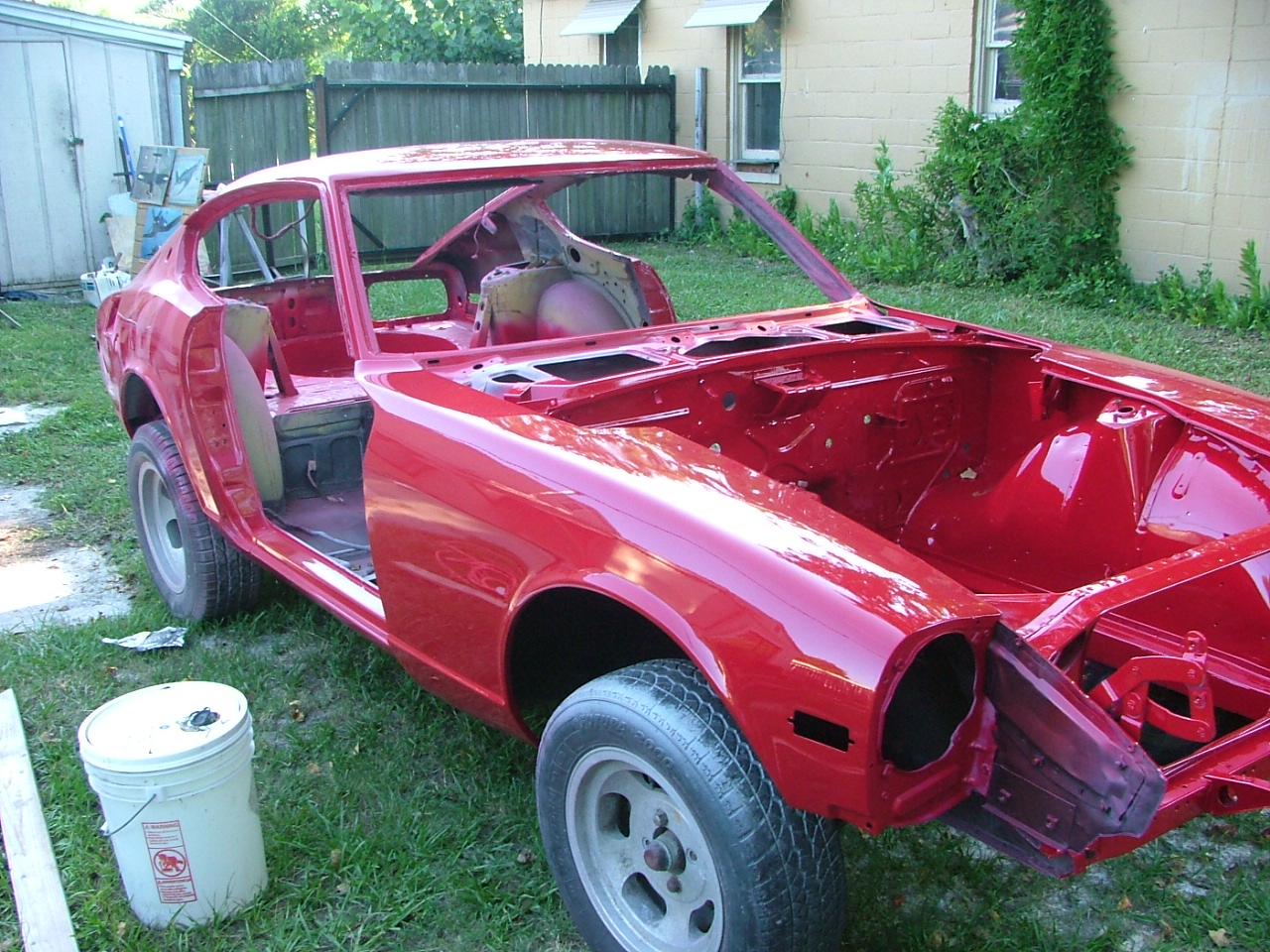

It all depends on how far gone it things really are and how far into the project you are willing to go. When I performed my engine swap I took the time to remove nearly every last thing and respray in sections over the course of a few days. I did all the work myself and had the original type acrylic enamel mixed up in spray cans. Cost me some paint, sandpaper, degreaser, POR-15, time and labor. For as cheap as a few hundred dollars in paint supplies it came out very nice I think.
The attached pictures are the same engine bay before the engine swap and after.
I also replaced many things with new, good used, and NOS parts and took the time to hand clean every last nut and bolt. That adds to the overall effect.
I will tell you now that the corner behind the brake booster would be a very tough spot to paint without removing some of the surrounding lines and componentry.

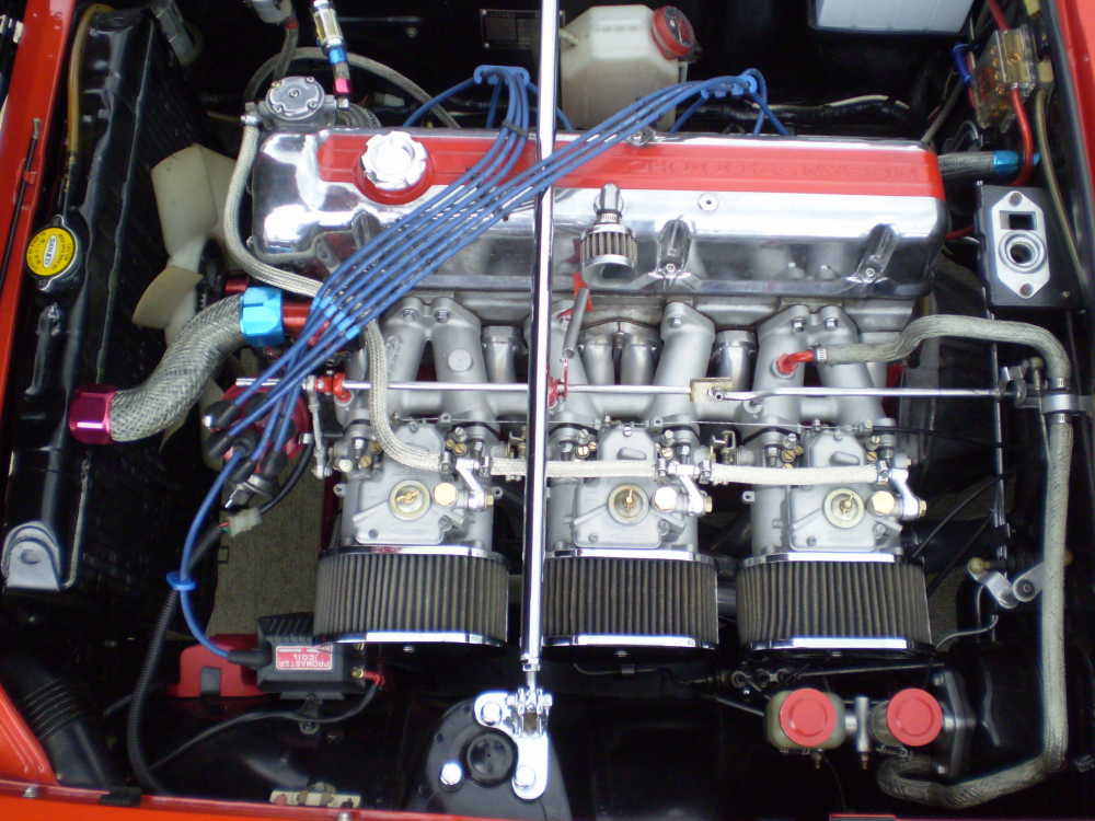

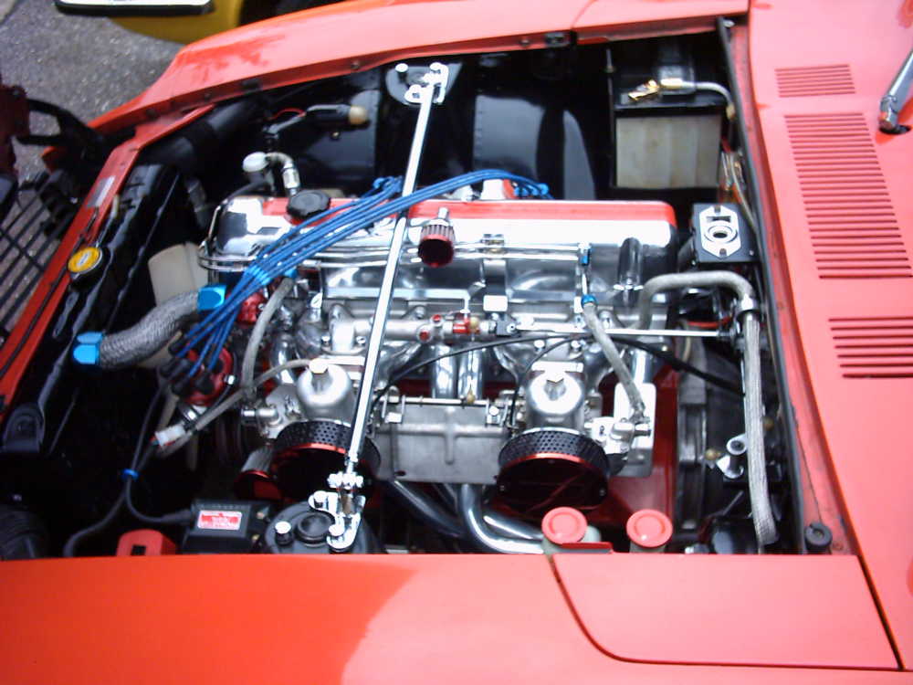

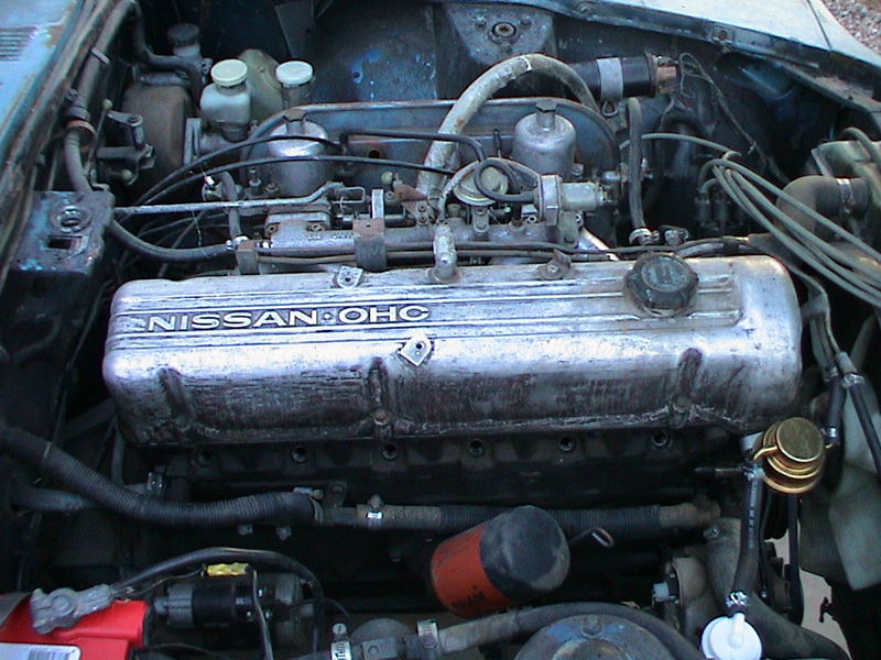

About 6 years........ Give or take a few years.....:stupid:

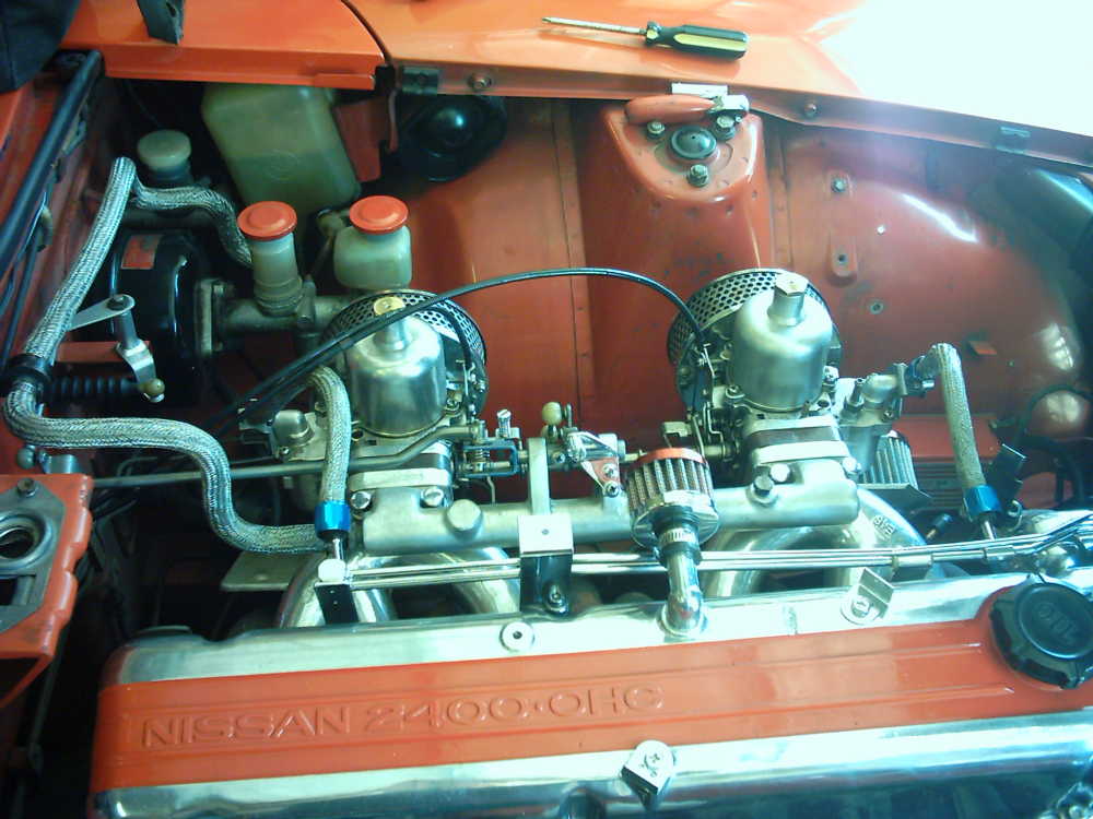

In the pics below, you'll see the old color and the new color. Took a few days cause the longblock was still in there when I did it.
First two are of the old
Second two are of the finished bay
The third is of the new Triples in the same bay.
All the bling was basically "A little here and a little there" with no real set time limit or measurable hours.
Dave
