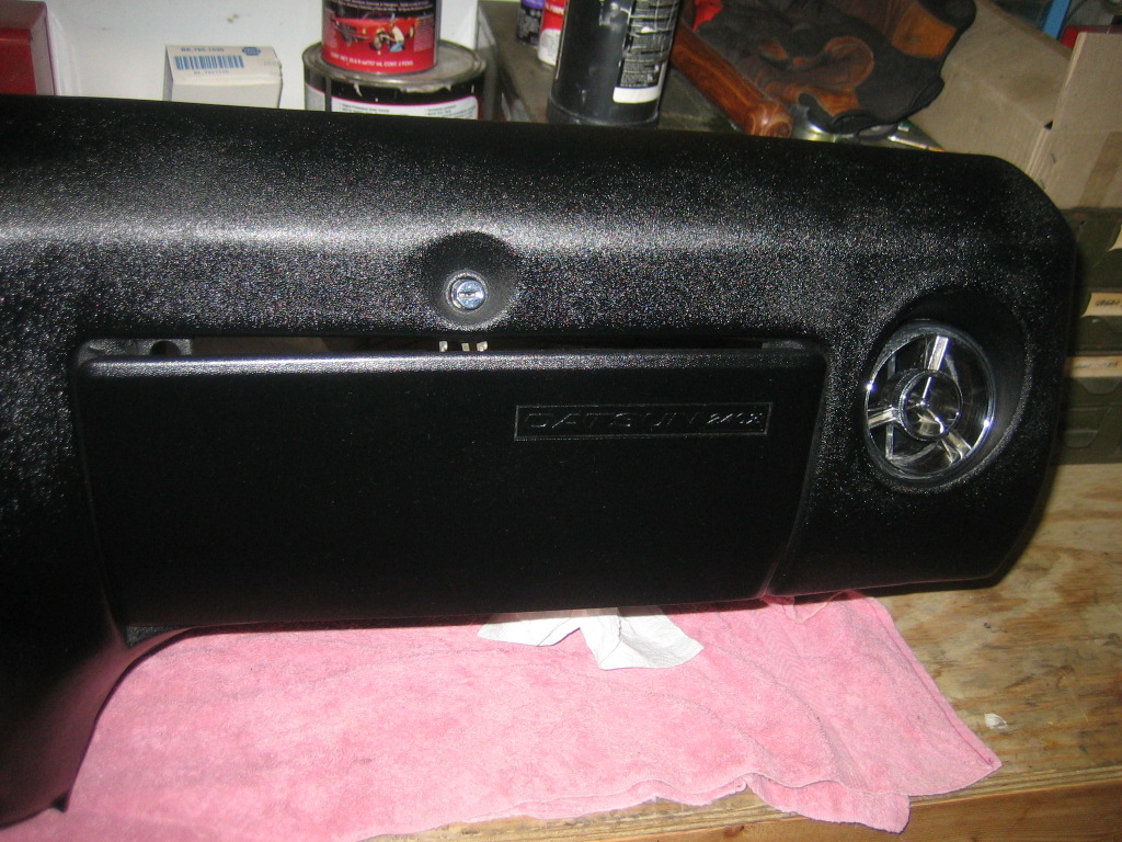

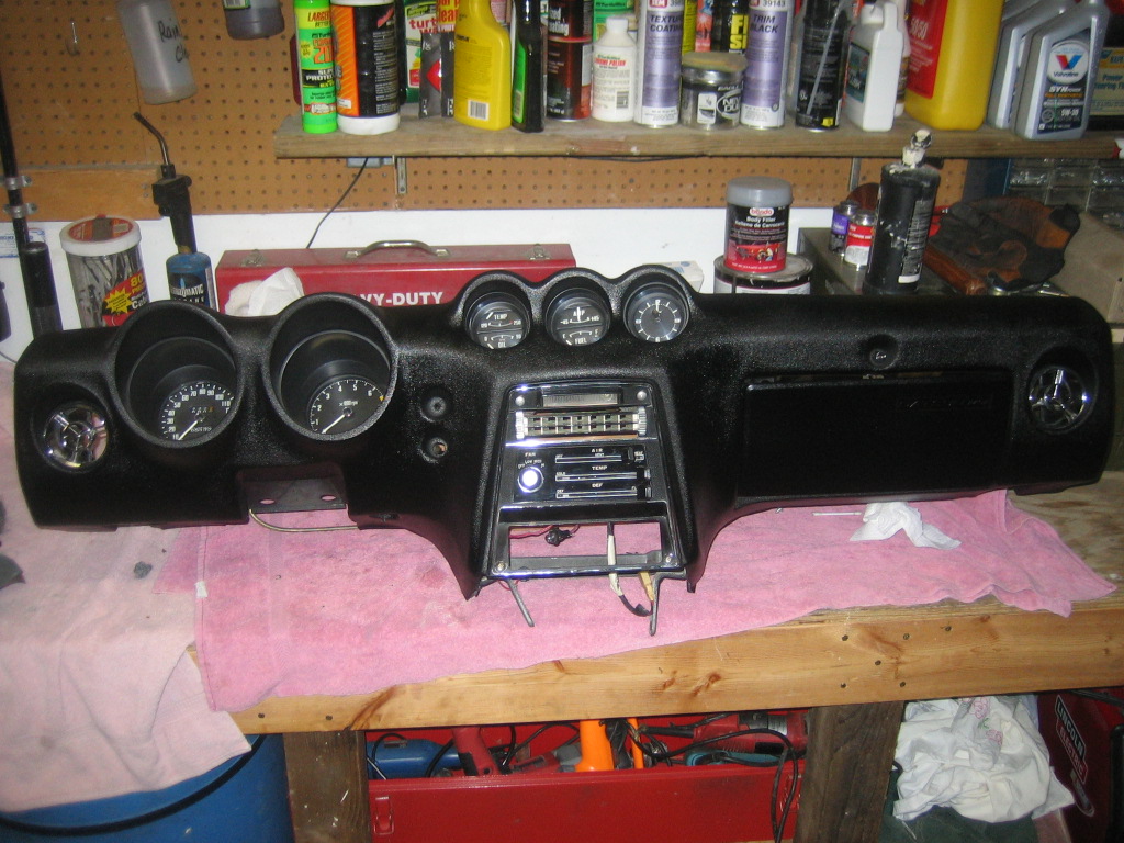

I have had good luck with duplicolor and they do have a vinyl paint thbat works well on plastic. Sems makes good stuff too. In fact I used both on my dash repair. The duplicolor finish was almost to glossy for me and I dulled it with a little 00steel wool rub down.

I've used the Dupli-color on my black vinyl and it came out fantastic. This was over a year ago and it looks as good now as it did when I first sprayed it. It is a nice glossy black. Your statement that it is garbage is incorrect.
As madkaw stated, they have a product that works on plastic and vinyl. If you have no experience with these products, then refrain from making any statements.
I too have used Dupli Color with good results so I can also attest that it's not 'garbage'. Did you clean the panels thoroughly before spraying? Residue from stuff like Armor All and 'turtle wax interior shine' will affect the way the product works. There's an old saying-----'It's the singer, not the song'
I have used the Duplicolor gloss black vinyl paint, and it came out glossy. I used it on the door panels, dash cap, center console and the heater/vent panel. I even used it on the pad for the center armrest, and it's still nice and shiny. I just used a good claner to clean, and some wax & grease remover before painting.
