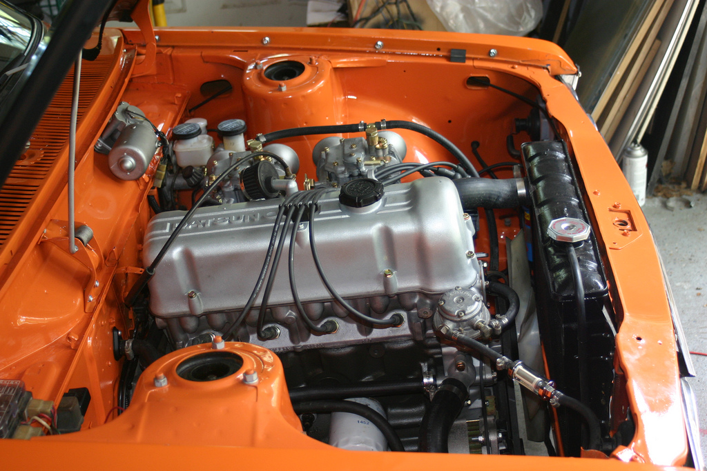

I bead blasted all the parts in the 510 and then painted with a light coat of aluminum wheel paint followed with poly satin clear by minwax. I have been told that stuff holds up best on aluminim in an engine bay. here are the pix. before and after
Nice results, five&dime! I assume the Minwax poly was a rattle can, or did you brush it on? I didn't ever consider that; wouldn't have thought it would take the heat.... but based on your pictures, I guess it does. Is the poly resistant to petroleum products (e,g. oil/gas/etc.)
I used the rattle can for that. The machine shop we use said that the minwax will not yellow over time with the heat or the oil/grease. I used it on my BMW engine parts as well. I drive that daily and the front cover etc still look great!!
That's great to know. One problem with some of the clear coats, even the high-temp stuff, is yellowing. I'm seeing a small bit of yellowing on the cam cover I have on my '72. Are there any Minwax product specifics, or is all of their poly satin clear the same stuff? I want to pick some of that up & want to get the correct product.

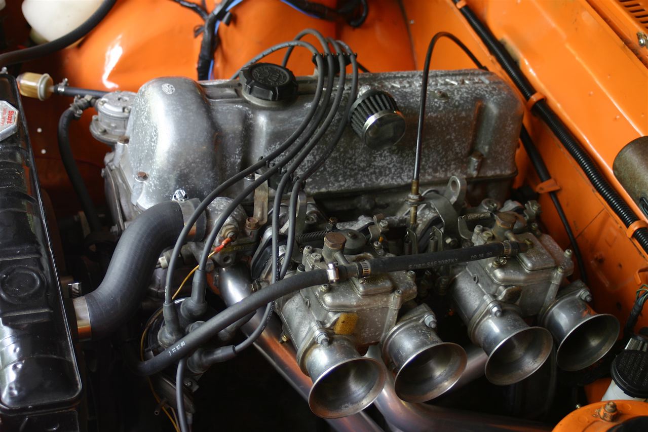

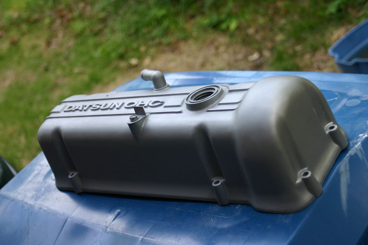

I took some pics of the motor today and the VHT paints used. One is VHT Flat Aluminum (too dull and dark) and the other is VHT Caliper enamel Cast Aluminum (too bright). I painted everything with the bright one, then gave a light coat of the dark one to take the shine out. The valve cover and distributor body are just blasted and sanded. The valve cover is a tad dark because I havnt cleaned off the metal polish completely, so the distributor is a good color reference.
When I resized the pics it turned them on me..you'll have to tilt your head (and I had to throw in one shot of the new paint job)
It was a really bright day here and the sun is low..I cant imagine this much light will ever hit the engine bay.
