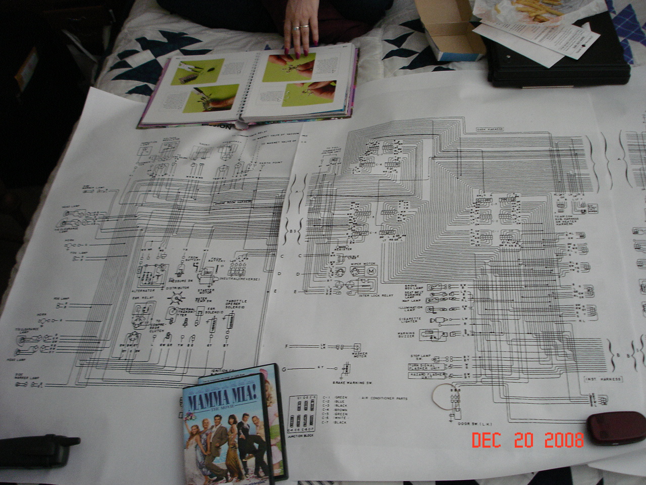

I Have a FULL Diagram for the 260Z GIF but it's way too big for me to post here. If you email me at wolfin32z@yahoo.com I'll send it directly to you. I got it from a guy a HybridZ. I went thru the entire thing and straightened every single line and item on the diagram.
The first Original is 6913 X 2670 and the reworked diagram is Half that at 3456 X 1335. Way to big to post here. I took it to the local print shop and the gal there printed it into the four sections on 2 foot by 3 foot pages. So in total, the larger diagram prints out at 8 feet long by 3 feet tall.
Once again, this is for a 260Z but most of it should work for an early 75' 280Z. But here's a PDF of a 75' 280Z that should get you going.....
