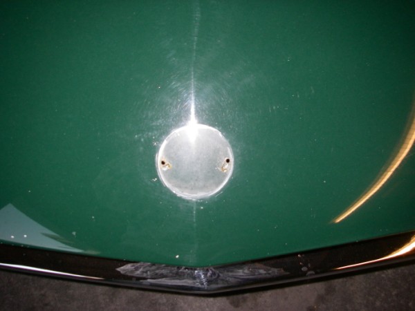

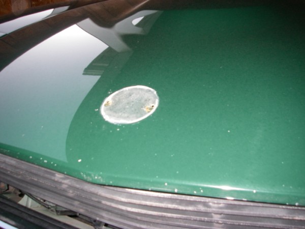

I was driving around on errands the other day and it occured to me that the roads had gotten considerably rougher after the couple weeks of snow we had.
When I got home I just happened to take a look back at my hood, an the emblem was barely hanging on! It had apparently vibrated off.
It looks like the two pins were lined up and it simply got glued in place before. I was wondering what sort of glue should I use? Is this how it should be attached? The pins are clearly not a press fit.

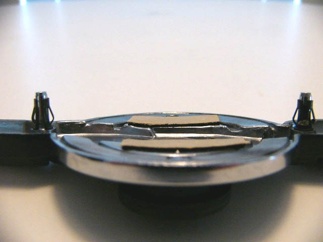

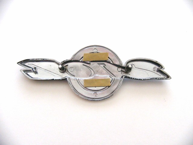

I don't have a hood emblem to show, but here are some pics of one of two NOS Series 1 metal quarter panel emblems I have.
As you can see, new out of the box, it comes with both the barrel clips and adhesive tape.
I am drooling!!!! Where did you get those?
