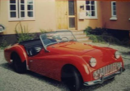

Suspense release time… yes it’s a Triumph TR 3A – picture below.

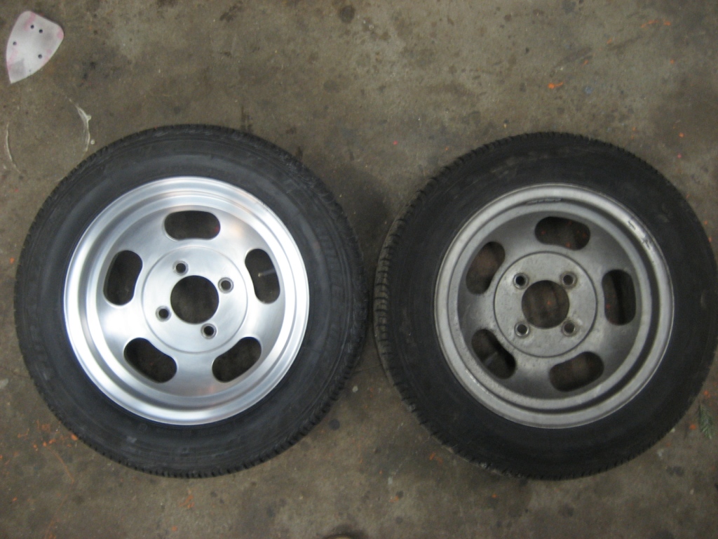

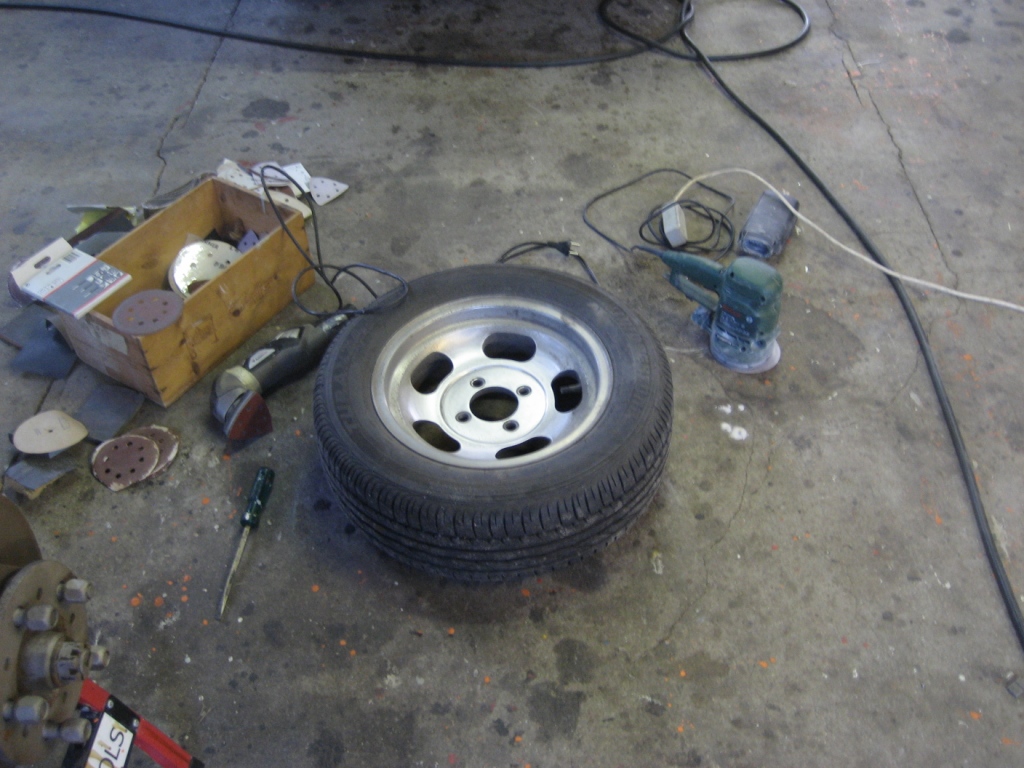

The wheels needed some attention which included some power tools and a lot of sandpaper in the following order – grid 80, 120 and 240 dry, 500 and 1000 wet – to finish it up some aluminum polish. Some before and after pictures below.

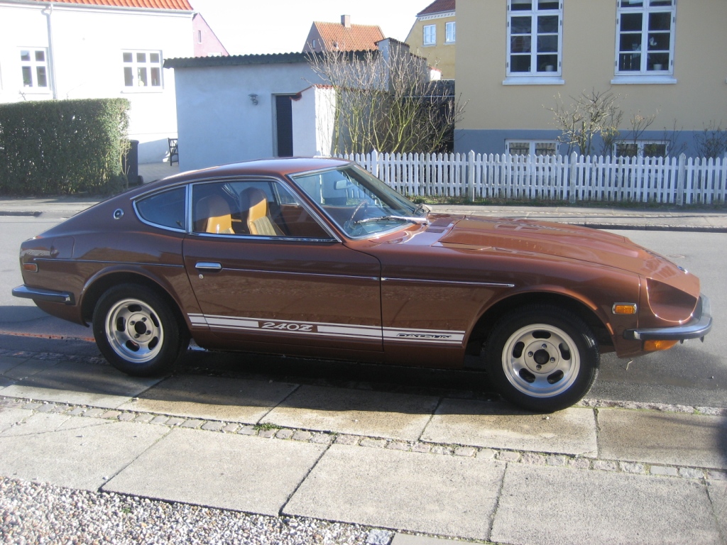

Sunday was a nice and sunny day so I washed the car and I am very pleased with the final result
Monday I was back in Copenhagen and went to get my number plates and Thursday I will go back to my parents for Easter – and the first drive in the finished car:cool:
