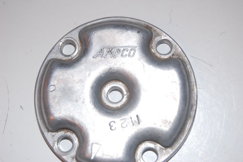

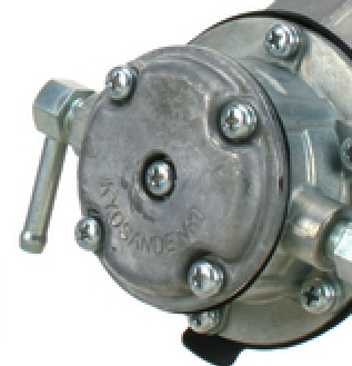

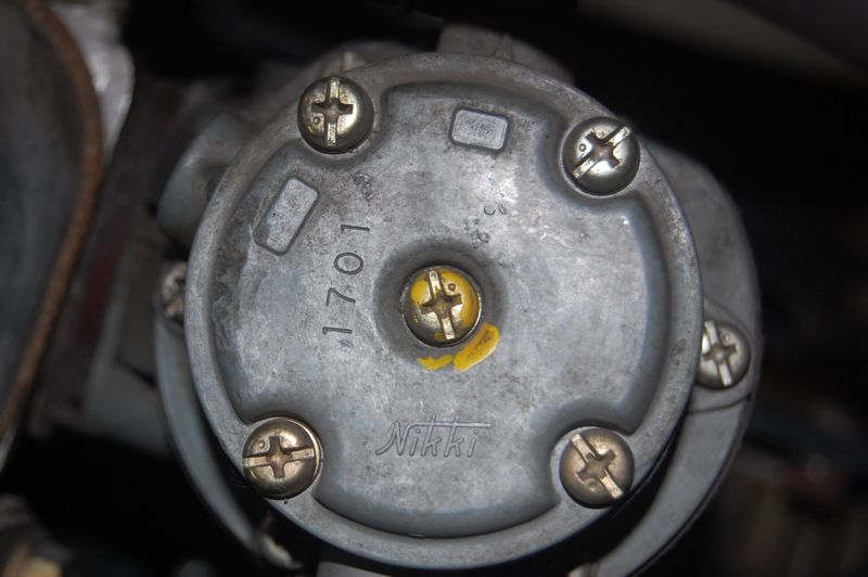

These days, the new OE-style pumps seem to be made by 'Kyosan Denki'. But my original says 'Nikki', while a spare top cover I received says 'Ampco'. Any others I've missed?

That Ampco cap (doesn't sound Japanese, does it? :confused:) came from a very original, one owner, 48,700+ mile 1973 240Z that I recently purchased.

This car had the "disease" (common in the 73 model) and I was told by the PO that they replaced the flat top carbs with the Webers. The fuel pump was replaced as well. (part of the shotgun approach to the cure) It was in another box and the rest of the pump looks damn near new, so I am 99.9% certain that it is the original.

No Jim, if I wanted a Denki I'd have simply bought a new pump rather than rebuilding the one I have. Like the '73 you have, the history on my car is pretty complete, and I'm comfortable that the Nikki pump on mine is original also.

Nikki is OE for 10/69 - 5/72

Ampco is OE for ?/73, possibly also a later replacement
Kyosan Denki is a current replacement

I replaced mine last summer with a 'Denki' unit. I just checked my parts bin and the old one was an 'Ampco'.
Now I don't know if that was the original pump or not, but after reading the previous posts I'm inclined to think it's not. In the late 70's my car was converted to dual Webers (how dare they!) before being switched back to SU's in the late 80's.
This leads me to believe my pump may have been replaced as well when the carbs were switched.
Picture #1
My 70' and I think that's the Original, I could be wrong
The red bolts are 1/8" longer than stock because the stock screws kept trying to strip when tightened down.
Picture #2
My 2/74 but the Round top conversion was done so it may be from another Z? Not sure as I don't know the whole history of either car and their P.O's
