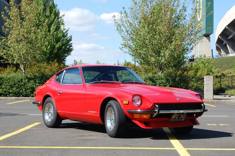

My car is quite similiar to Arne's. Only 30,100 miles on it now. Almost unmolested except for the splash pan and battery cover. Could use some paint, still the original paintjob, but I keep it as a survivor...Here's a picture from the front that I like.

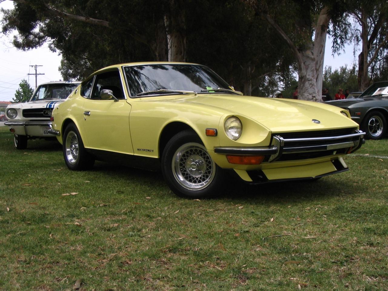

BTW - from your avatar, your car looks like Arne's in yellow (similar rims and air dam).
Yup, the exact same rims, and other than the fact that my spook was built within the last 18 months, the same.
Mine has a bit more than double the miles on it (>66k now), and has been repainted once when the sunroof was deleted. All the other mods on it can easily be restored to stock - steel fan, AM radio, Koito headlights, alternator, etc. I still have all the original parts other than the same splash pan and battery cover Randy mentioned, and I don't have either the original exhaust, nor the stock wheels and hubcaps.
Here's a similar picture of mine, a larger version of my sig pic. The similarities (once past the color) are striking.
