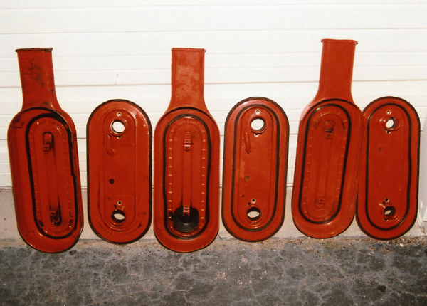

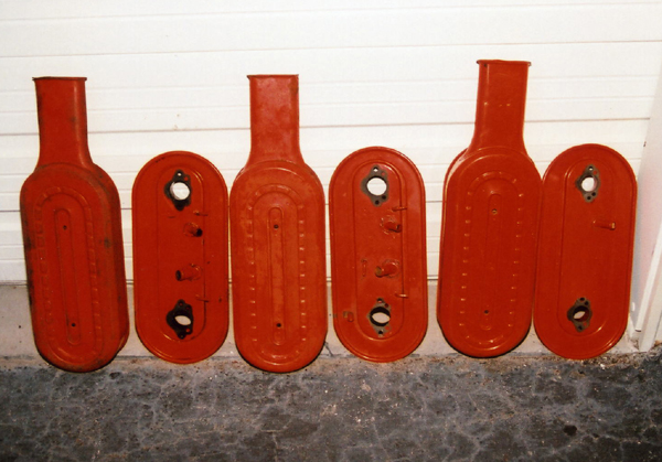

To be correct, I am sure that your 12/70 car had the hot manifold air snorkel with the diverter flap. My 1/71 car, very close to your production date, is one of the very last of the series 1 cars and has the snorkel. I can't quote dates, but the terrific pictures 26th-z profiled are for early '69 & '70 series 1 cars which did not have the heat riser, possibly up to the start of '71 cars in 7/70.
According the www.ztherapy.com, the late '70 smog laws required the addition of the heat riser for carb pre-heat. If you have the original exhaust manifold, you will notice two holes on top of the junction area where the hot air collector cover is attached to the manifold. These threaded holes were not on the early cars that did not have the heat riser.

Oh geeze, I guess I didn't notice the 12/70 part of the question. That would make the car a 1971 model year and the preheater throat would be on the air filter housing. I don't have any of those to photograph. And here I was all prepared to get into a discussion about the differences between the early ones!?!! Sorry guys.
adamr, I have a few I can dig out and get pics of, but I've lost track of what they came off of and can't date them. Guess I could use a comparison pic also. I did look in a few manuals but the illustrations only show partial outside views. I don't know how many variations there are of the later flap type air cleaners.
Nice pics of the earlier air cleaners Chris. I was just comparing to the only
non-heatriser, flapless air cleaner I have. It appears to be like the one you show in the middle of the 3 in your pics. Should that be labeled? This one seems unmolested, but has no labels and I can't see any evidence of removal.
