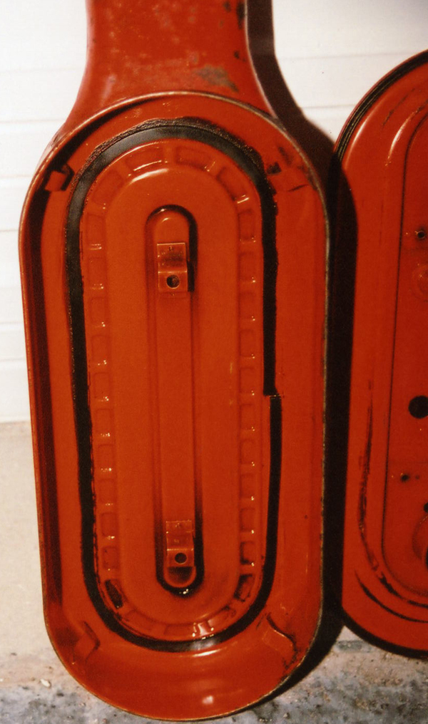

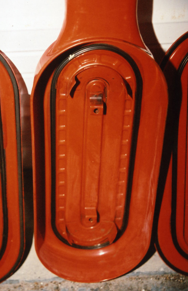

Going back over this thread... Ron, I bought the air cleaner in the middle. Can't confirm what it is from.
Here are two different filter element alignmet methods. The picture with the spring clips on the outside is from Her Majesty the 26th.
