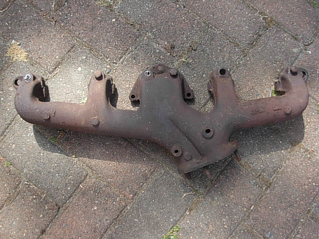

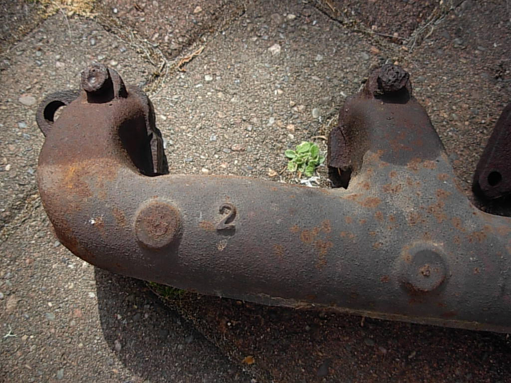

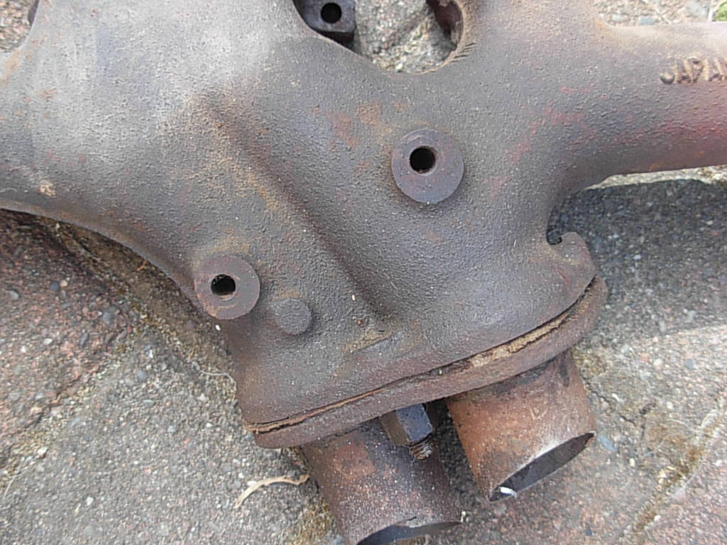

I took some pictures of a few exhaust manifolds I have handy (ignore the plugs for the removed air injection tubes). The first manifold is from HLS30-00210 (a 11/69 production car). Notice that it has a casting number 1, and has the two raised circular areas where the air cleaner hose heat shield is mounted in later cars, but there are no bolt holes drilled. It also does not have the three raised circular areas on the left and right side connecting tubes of the manifold. The second manifold is from HLS30-00331 (also a 11/69 car). It also has the casting number 1, but the two bolt holes for the air cleaner heat shield have been drilled. The third manifold has the casting number 2. Not sure what the production date was on the car that came from. I don't have my two other 1969 production cars at the house right now, so not sure what they have. Its kind of difficult to see mounted on the car, but my 5/72 car has a casting number 6 on its manifold.
