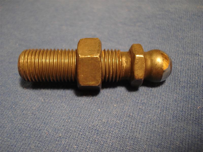

I havn't got much time here, but I have a pic of the adjuster. The top 14 mm nut is the adjuster, the 17mm is the lock nut. Don't try to turn the 14mm adjuster without first loosening the jam nut. The 17mm nut is sometimes pretty tight, but the adjuster is rarely tight. Point the lobe up, and set intake at .008, and the exh. at .010 cold. good luck.
Phred
