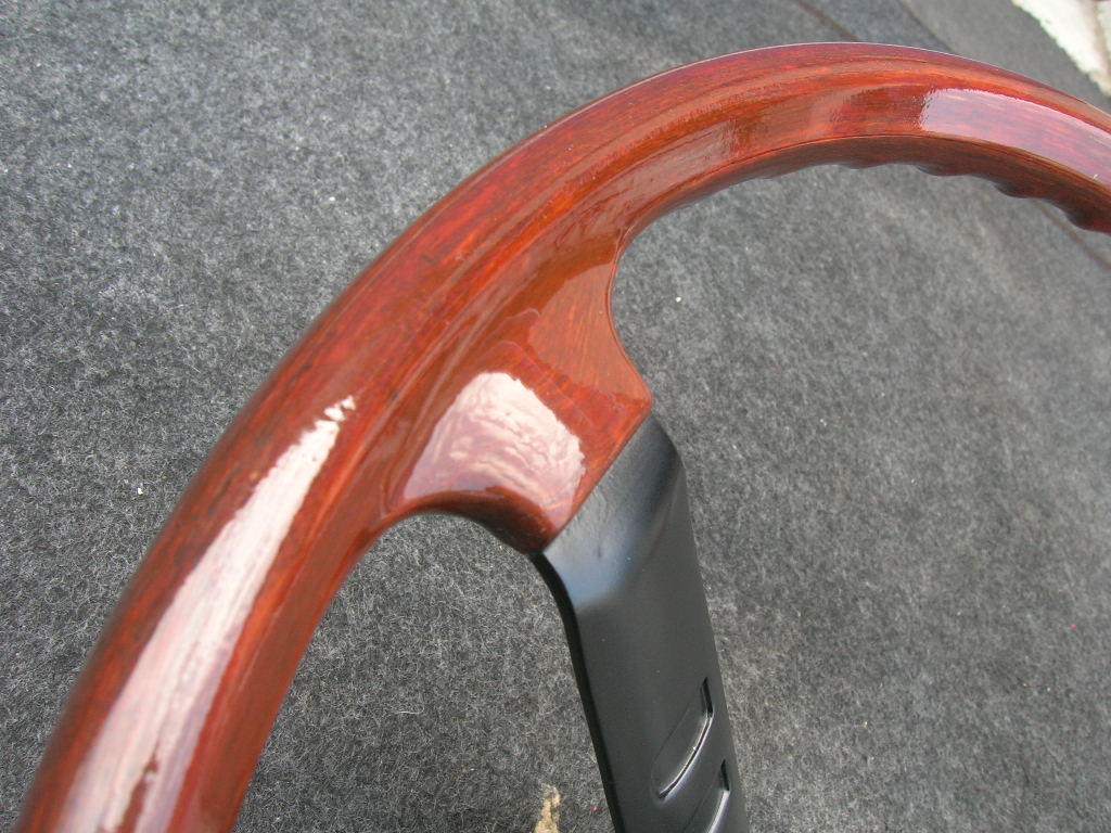

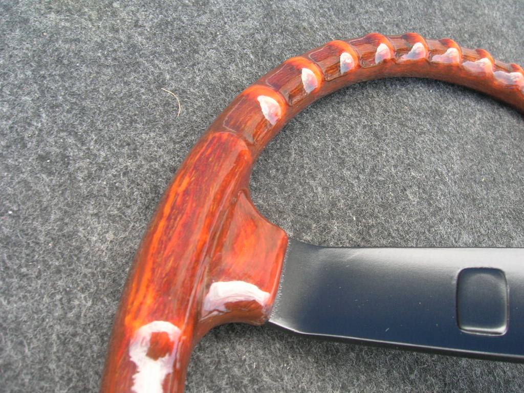

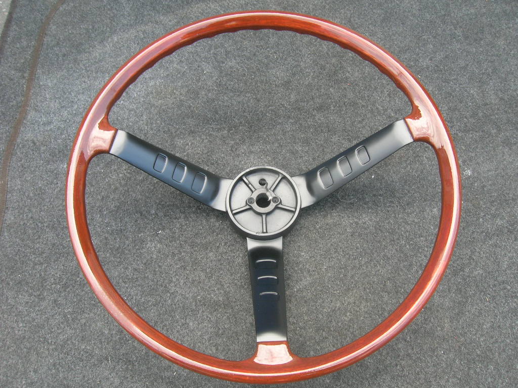

old topic.. nice steering wheel!  My problem was it is to thin.. so i took of the "wood" and put on some mahogany with the use of a hand milling machine made me a new wheel... after lots of sanding and 8 coats of lacquer it was beautiful..
