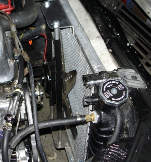

If you want to spend the money, here is the setup that I am going to be running. I am VERY close to firing this up for the first time!
I bought the full kit (Radiator and fans) from MonsterRadiators on eBay ( http://stores.shop.ebay.com/Monster-Cooling__W0QQ_armrsZ1 ). Total cost (with fans) was about $250 shipped! The radiator bolted right in with NO MODIFICATIONS! He does not have any listed right now, but you can contact him if interested. Each fan will pull 8.5 amps - it is worth doing the ZX alternator upgrade.
I am guessing that I should not have any cooling issues... :D
Tim
Here are pics of the radiator and fans and the clearance between the pulley and fans.
