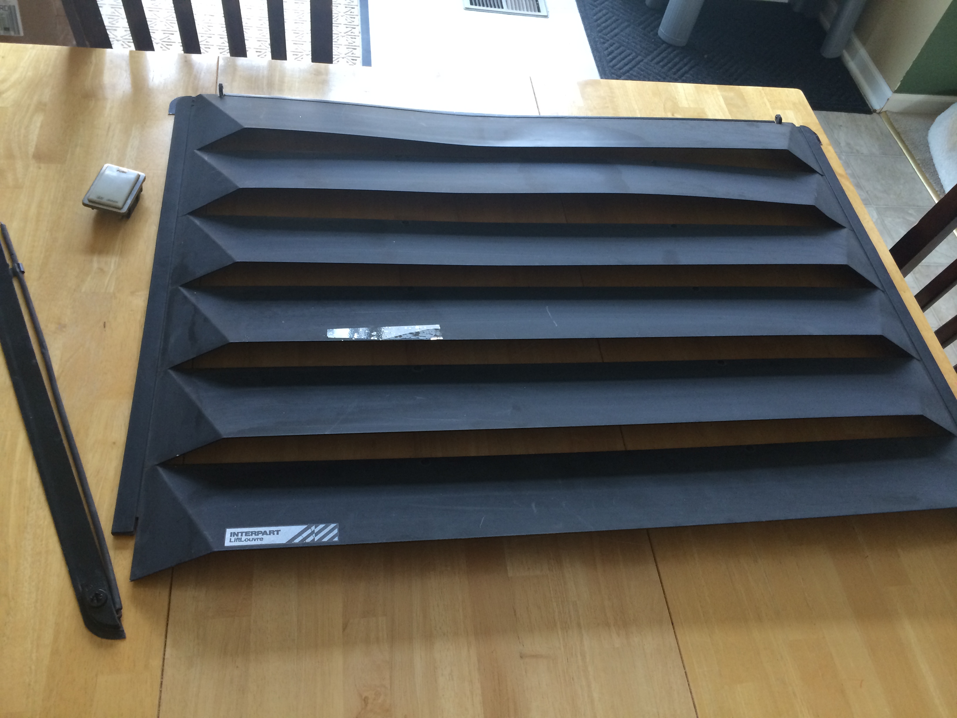

I had the type of louvers that you are looking for and I was disappointed with how it mounts onto the hatch and so I got rid of mine about two years ago.  They pop up every now & then for around $150 on this site and/or ebay.  Just be forewarned that the mounts need to slip under the rear hatch window seal, It didn't look like it would be very water tight.  Also, louvers will always rattle.
i pulled a set like that off my 280 and can attest to the following issues:
  • distorted rubber seal = leaks (had to fill w/silicone)
  • popped up/damaged the sst trim insets
  • scratched up the hatch glass at the mounting points
  • rattled incessantly
not saying louvers in general are a bad idea, just be careful how you go about it. i've found i don't miss them at all from a glare standpoint and the car looks cleaner w/out them imho.
