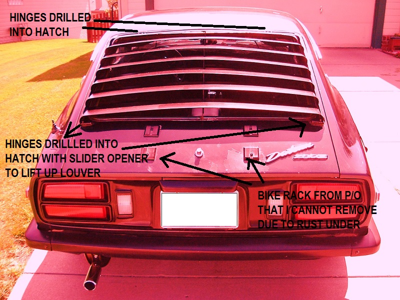

I did some silicone and rubber gasket work to the louver to minimize the clanging noises.  Sorry for the color filter, I was playing with Photoshop and lost the original...
I'm not sure what "type" of louvers I have, but I kind of like it.  It has two slider hinges on the bottom, so I can lift it up to clean, etc...
But it is drilled into the hatch in all 4 locations.  Not sure there would be a way to install without drilling.
I actually removed the louver once, since I do like the smooth look of these cars without them, but the condition of the paint underneath the louver brackets was not good.  So I painted the louver and put it back on.
Definitely helps with some sort of privacy and heat reduction, and is awesomely retro for this generation of cars.  I like mine, not a fan of the other, more "square" style though.

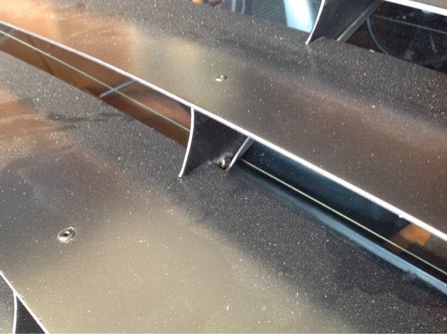

The louvers rattled A LOT, and once removed and weatherstripping pulled off, it was easy to see why. The outside frame was cracked, clean through on the right side, and the center spine was cracked through, both above and below the middle louver. The only things keeping the louvers together was the left side of the frame and the weatherstripping! Over time, the rivets get lose, allow the louvers to rattle, leading to fatigue and cracking, which allows more movement, rattles and cracks, etc...
I took the louvers in to a local shop, and had the cracks welded (not entirely pleased with the welding job, but the cracks are fixed);

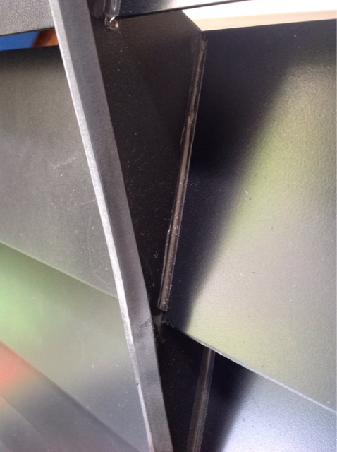

I drilled out the rivets along the center spine and replaced them;
I applied black caulking on the underside of the horizontal slats at the center spine (the idea being to further reduce any movement between the center spine and horizontal slats, the caulking can't be seen when the louvers are installed);

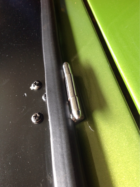

Polished the hinges (would have liked to replace the hinges due to some corrosion, but couldn't find a good, chrome replacement);
Modified some door weatherstripping I had in the garage and installed (1st used weatherstrip adhesive, but wasn't happy with the adhesion so used more of the black caulking and clamps, instead).

Here's a pic of the underside of one of the louvers with the black caulking applied. Taped up before I caulked, smoothed with finger and removed excess.
Drilled out and replaced all the rivets on the centre spine.
Here you can see the globby weld job on the centre spine. The first time they welded up the spine and ground back the weld, it cracked while I was moving it around to prep for paint. Second time they welded the centre spine, they did not grind back the welds. Lots of material there now. I had to grind back some of the centre spine as they slightly misaligned the louvers when they welded them.
I wanted to buy some new weatherstrip from McMaster-Carr but they won't deliver to Canada! I ended up cutting the metal off some door seals I had in the garage. I had to cut slits in the top corners and remove some material to make the 90degree corners.
I also had to join two pieces as I had to remove the weatherstrip corner.
At the hinges, I removed some material on the backside to allow the weatherstrip to sit flat on the louvers.
I used weatherstrip adhesive the first time (yellow) but I wasn't happy with the adhesion. I decided to use black caulking to stick the weather strip and clamp in place (much better). I still need to clean up the extra yellow adhesive.
