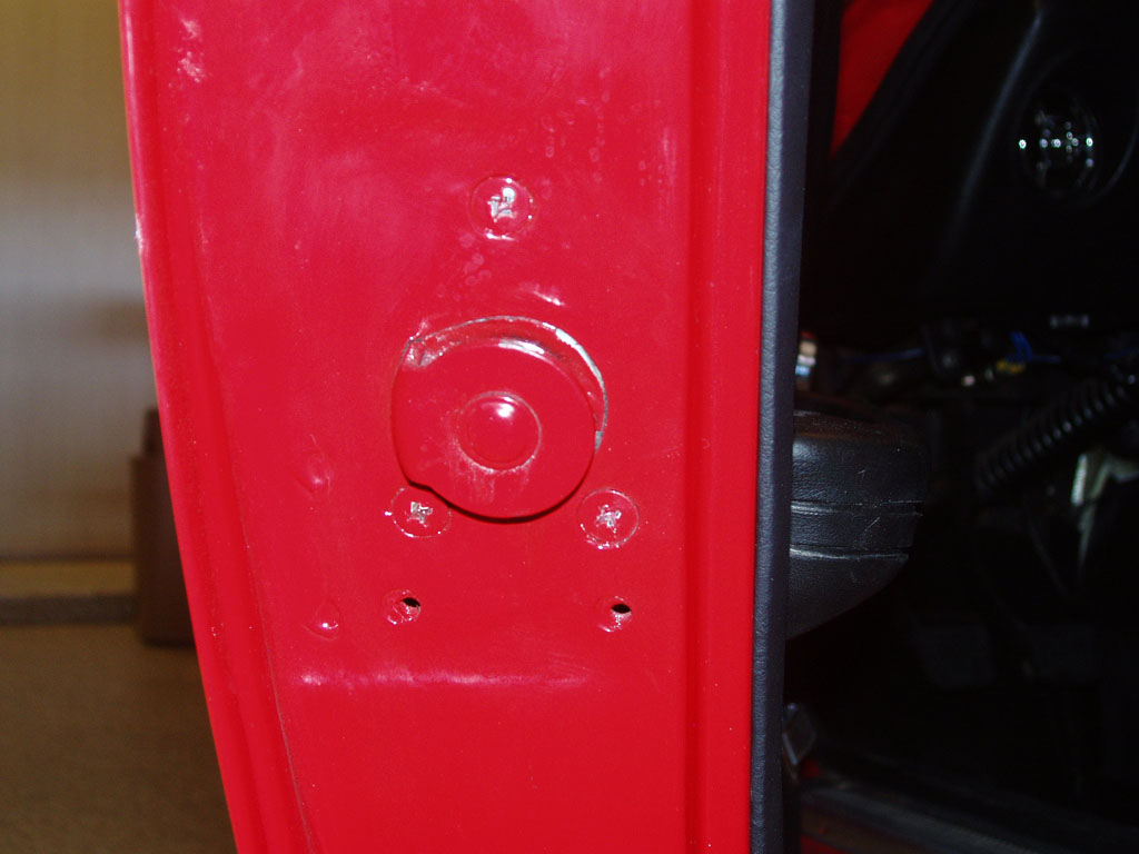

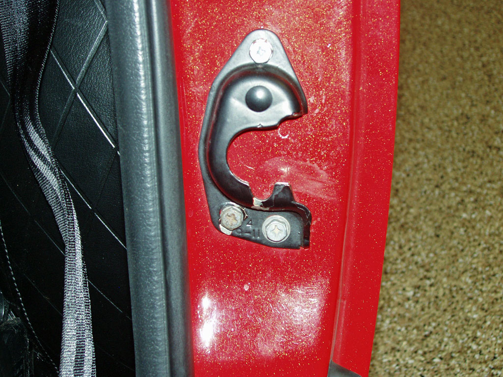

Ok, stupid question on my part, but what does this part do? I do not have either one on my doors and my doors seem to close fine. Here is the configuration of my doors (see pics). I had the car stripped and painted a few years back, don't know if I ever had those parts since I have owned it.
The dovetail keeps the door from sagging and actually lengthens the life of the hinges by keeping the door from moving while you're driving. In mid 76 they changed to what they thought was a better system but it's only as good as long as the bushings are in tact.
Edited by sblake01
in your pic on the left there are two lonesome holes, that is exactly where the dovetail would make itself home!
Yes, that's on the door itself but there's also the spring-loaded part that the dovetail slides against on the latch side which is missing in the other photo. Without that I don't think that dovetail would do any good.

Ok, thanks everyone for the replies. Does my latch look like the correct latch, other than missing the spring loaded piece on the frame? I am trying to figure out where the spring-loaded piece goes. Anyone have a picture?
It's a separate piece that is attached using the same two bolts that hold the bottom of the striker plate:
http://www.classiczcars.com/photopost/showphoto.php?photo=5616
i contacted msa this morning to inquire about availability of the part-which they call a 'door stopper'. last time in their inventory was 2007, priced at $21-each. now they are no longer available. bummer, i can't imagine how many i have thrown away. i will, however, have a few pair available once i get what i do have replated.
