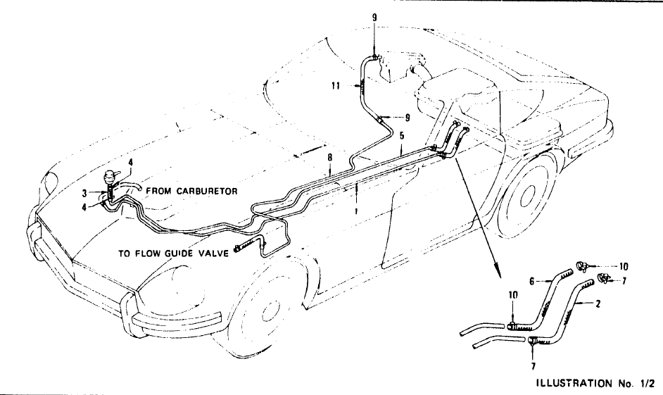

I've attached a schematic of the fuel piping layout for an early 240Z. Bear in mind that many 240Zs had no electric pumps at all, just a mechanical pump mounted on the cylinder head.
The electric low-pressure pump is best mounted in the same location as the high-pressure pump your car came with, right in front of the tank.
On a 240Z (and I assume on a 280Z as well), there are two metal fuel pipes both running between the tank and the right inner fender, in front of the wheel. (The pipes may terminate somewhere else in the 280Z engine bay, I don't know.) There is a larger pipe (fuel from tank to carbs) and a smaller diameter pipe (excess fuel return). The fuel supply pipe goes to a filter, and from there to the pump on the head, which pumps directly into the fuel rail and to the carbs. The excess leaves the fuel rail and goes back to the return pipe on the inner fender and then back to the tank.
In your case, the pump will be at the rear pulling fuel from the tank and into the bigger fuel pipe. You should probably mount an inline filter before the pump, and a second filter somewhere between the supply pipe and the fuel rail is a good idea as well.

Thanks Arne,
That helps alot, the only thing is my 280Z has 3 feul lines so i gues I can just eliminate 1 line, use one as a return, and the other as the main fuel sending line.

...the only thing is my 280Z has 3 feul lines so i gues I can just eliminate 1 line, use one as a return, and the other as the main fuel sending line.
That third line might be the evap vent tube. The diagram doesn't show it since it's not a fuel line, as such. On a 240Z it runs from the evap tank inside the car to a flow valve on the left inner fender near the coil. Again, I don't know how that compares to the 280Z system, but I assume that there may be a similar line for that.
