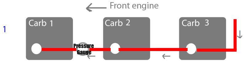

I am still lost as to where I plumb my return from based on my previous post^ Anyone???
With your current setup I don't see how it would be possible. This will probably open a can of worms, but IMO a return line should not be used with a inlet style pressure regulator but rather a bypass style - after the carbies liks an FI setup. It creates a potential for fuel starvation at high rpms because the pump then needs to supply enough fuel for both the carbs and the return line to maintain pressure.
the guy i bought them from said i should run setup #1 with a lower pressure fuel pump and a FPR that can be set to 3psi. some sources ive found that use setup #1 say the same thing. i tried sourcing a 3rd T fuel bonjo for setup #2 with no luck . i email dellorto in UK and its gonna cost $80shipped 7-21days just for that one bonjo. that's almost half the price of one used carb. i also said i wanted to run setup #2 in the email and said it would be ideal setup. they also recommended setup#1 with a low pressure pump 3-7psi and a fpr adjustable to 3psi. i guess thats why the setup only comes with two T's cause this how they expect you to run them.

i wanted to run a pressure gauge in line since the holly doesnt have one already. i gues the best place to put the guage would be right before the last carb inline to insure that im getting 3psi to the last carb too?
