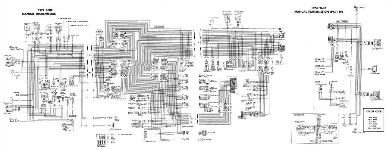

Also save the diagram below. If you email me at wolfin32z@yahoo.com I'll send you everything I have on 260Z's
