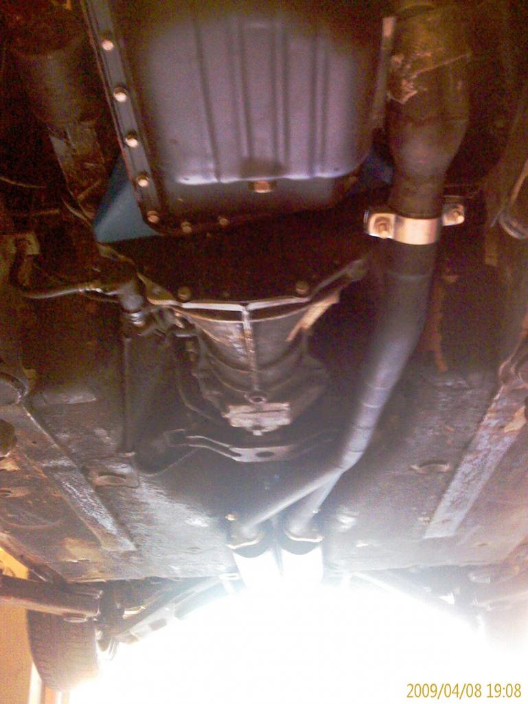

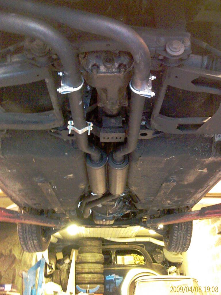

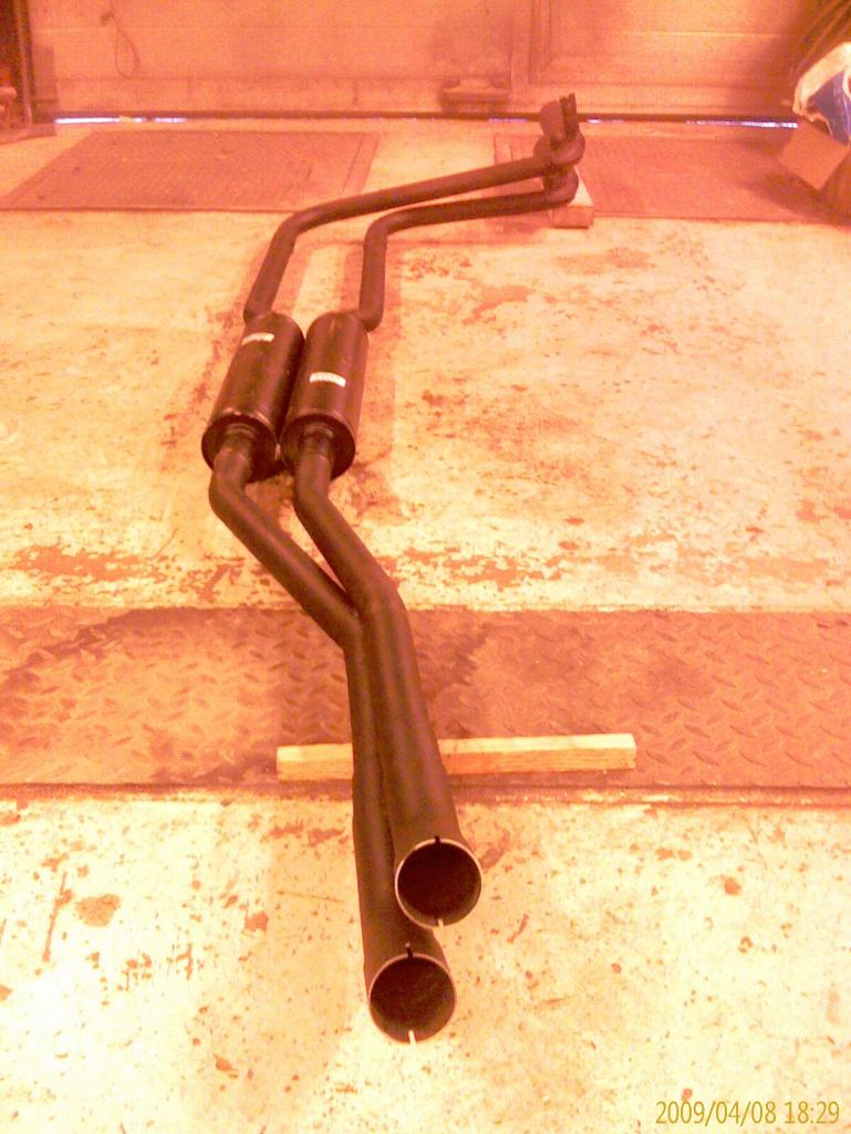

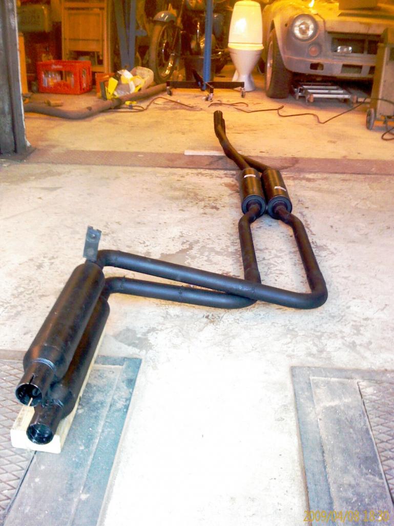

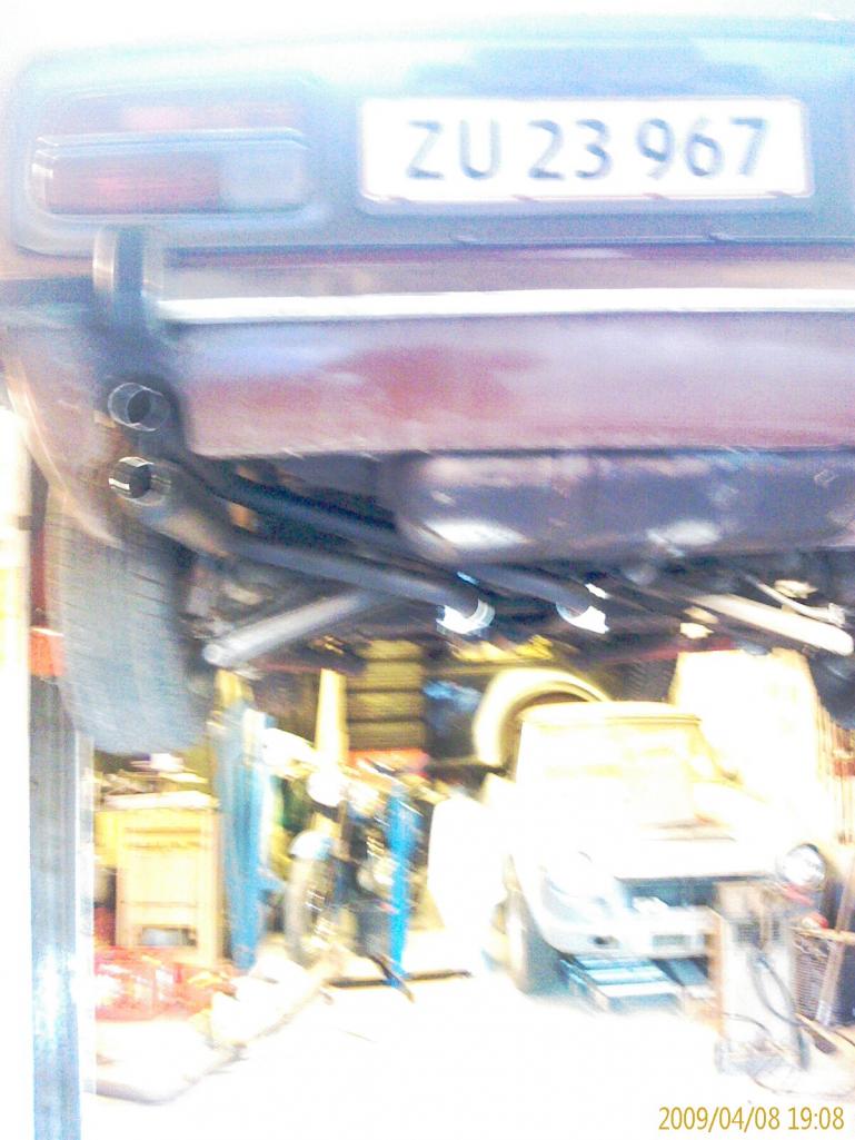

Hi guys, now it is my time to make a dual exhaust thread.
Since my car came with a 2.5 inch exhaust there after my taste was way to loud, i decided to make my version of the Clifford dual system, my decision was to use 1 3/4 inch pipe, being that it should be the same as 2.5 inch pipe in opening, some might remember this: http://www.classiczcars.com/forums/showthread.php?t=33819
The exhaust was suppose to have the same mufflers in the middle the same as the glasspack at the back, the guy at the parts store made a mistake and ordered tha wrong ones, well i talked him down to $16 a piece, decided to use them and if it don't works it won't be such a big loss.
I still need to make tips at the end, just have to figure out how they shall be made, but i promice you guys that it have one of the best sounds.
All parts used comes from Swedish "Simons" and is a good quality
I let the photos speak for them self.

In the 4th picture it looks like the first set of glasspacks is touching the body of the car. Is there space there? I would think direct contact would cause problems, making the floor much hotter.

It dosen't touch but it is vey close, the clearance is a ½ inch on that photo i actually flipped the middle section up side down, witch makes the rear section pull it towards the left side and also makes it sit higher.
I also need to make some proper brackets for the middle section, but all is closed for easter here and it can wait.
I will post a video clip but not before i get the engine to run good.

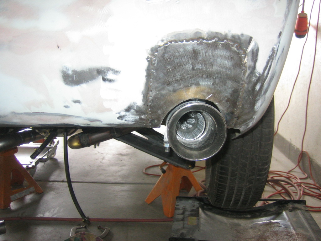

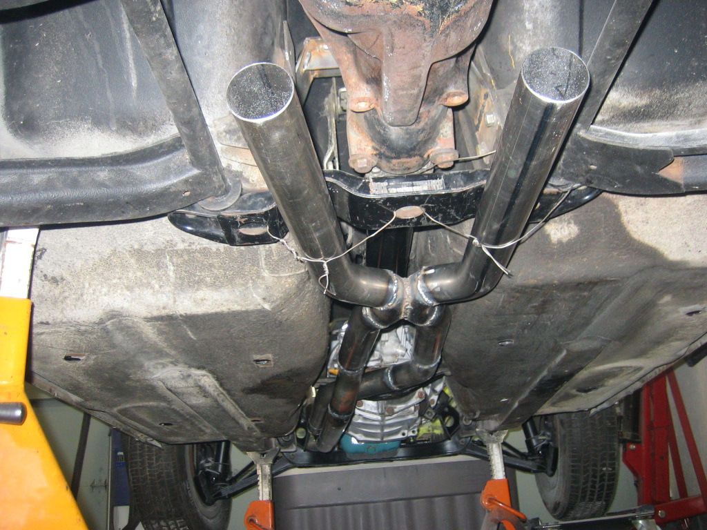

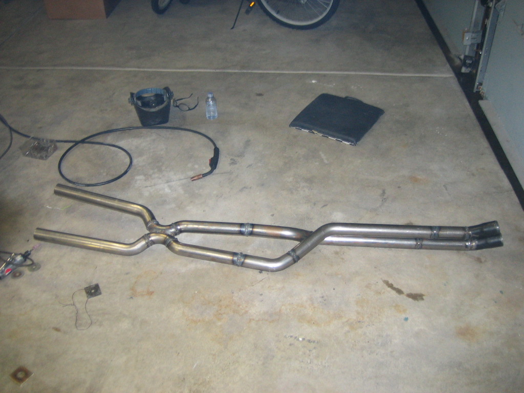

That system looks nice and oughta sound good, I am only using one set of glasspacks, but I installed an X pipe hoping to kill some of the resonance. I might have to get a quieter muffler eventually. That narrow tunnel makes it hard to fit anything in there. I just went with some tips that looked good Some pics of mine--
