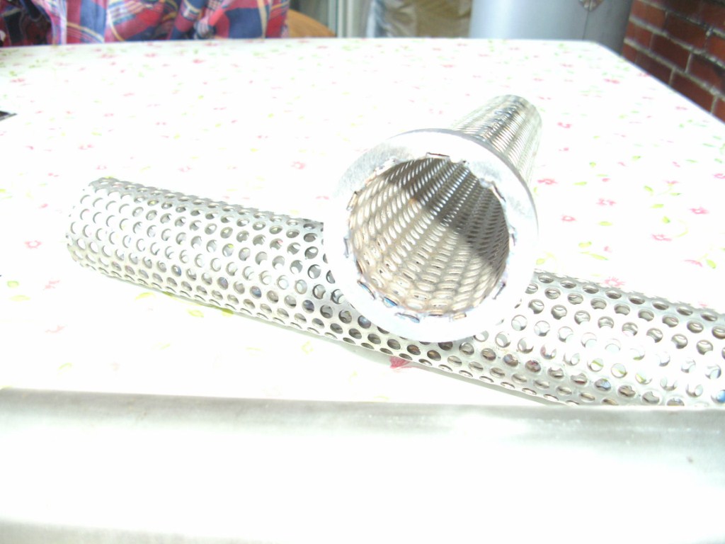

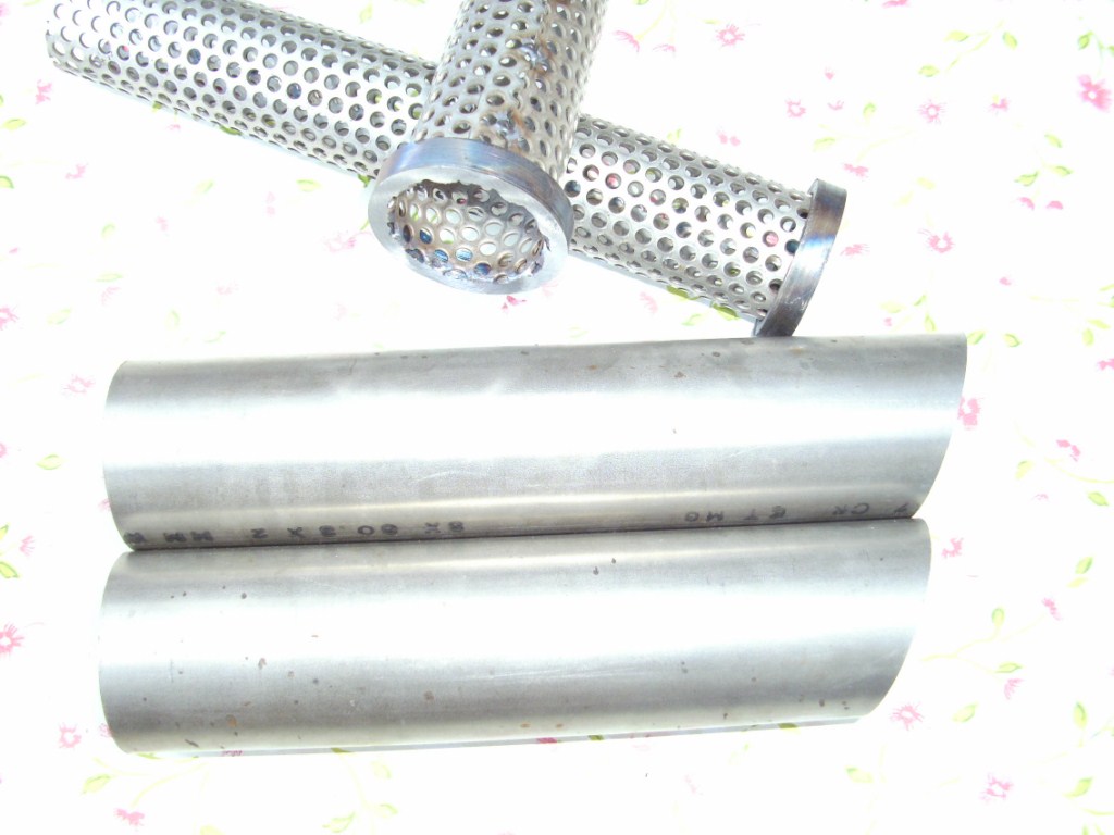

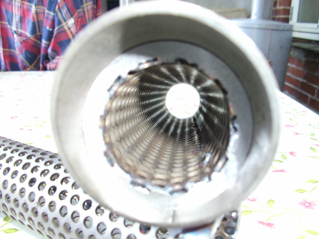

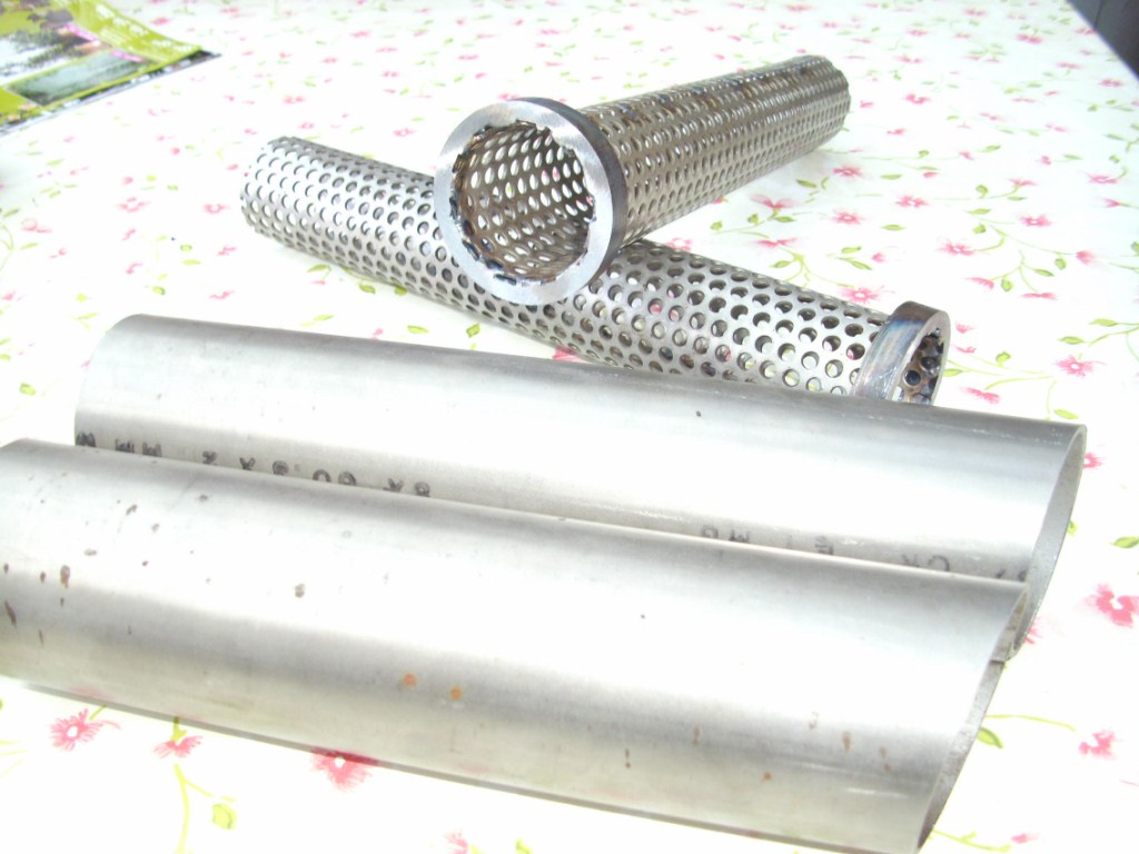

2010 and i'm going to get this done, gave up on finding some tips here, so i decided to make some my self.
Got some 2.5 inch stainless cut, rolled some perforated stainless and turned a ring on my lathe, so in the weekend i'm going to test fit this.
I hope the sound will be more "hollow"
Chris
Finally i got this worked out and got the tips on, i really like the improvement of the sound, it became more hollow as i hoped for.
