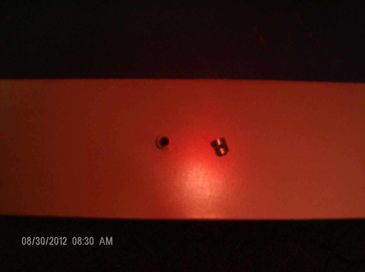

When mine broke, I put the pasenger side of the car on a curb, crawled under and pushed the release with my finger. You get a clear shot at it from the pasenger side, no problem. I should add however, I have a 32" reach.
As a fix, I bought a cable end with a set screw from a local bike shop, trimed the cable jacket back an inch and hooked everything back up. Worked like a champ, cost less than a buck.
