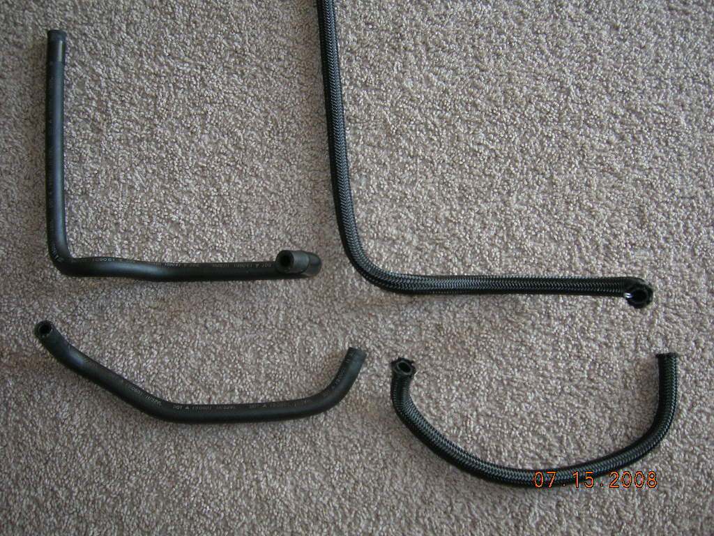

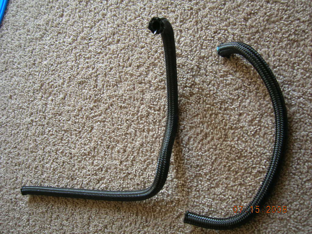

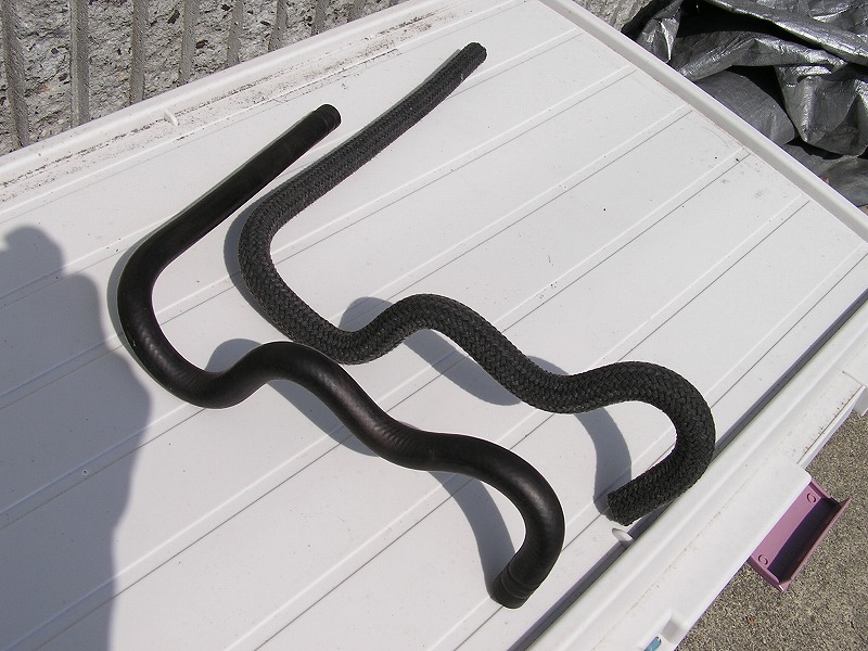

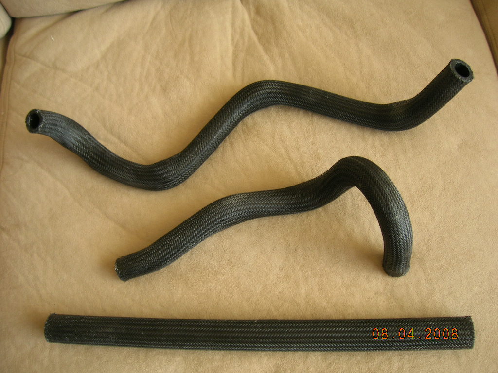

This is the one I made. You could buy the hose and put the wires inside.

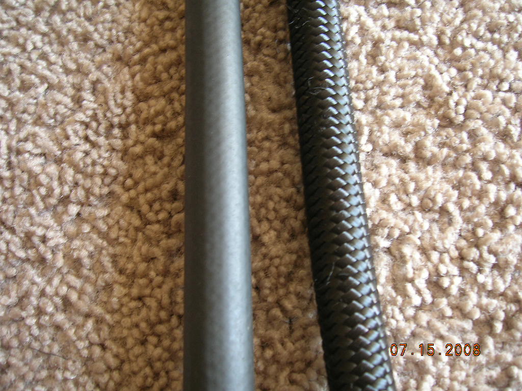

In the first picture, Left ones are original non braided ones. Right ones are reproduction ones (braided)

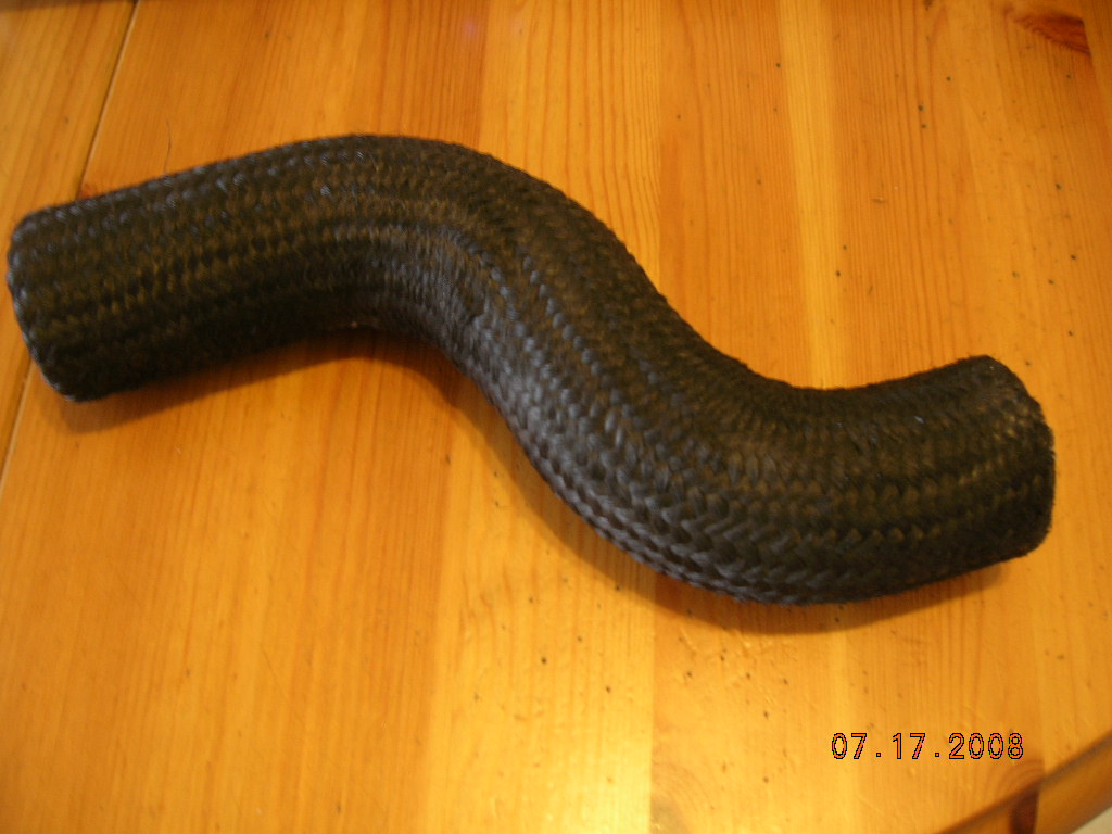

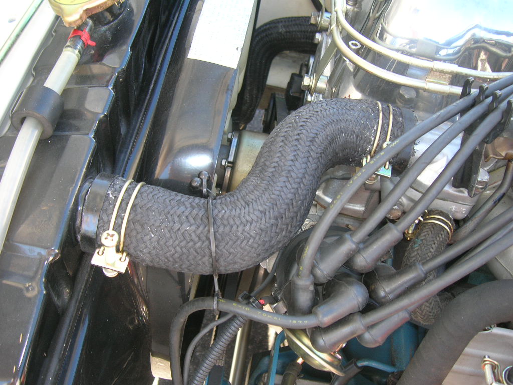

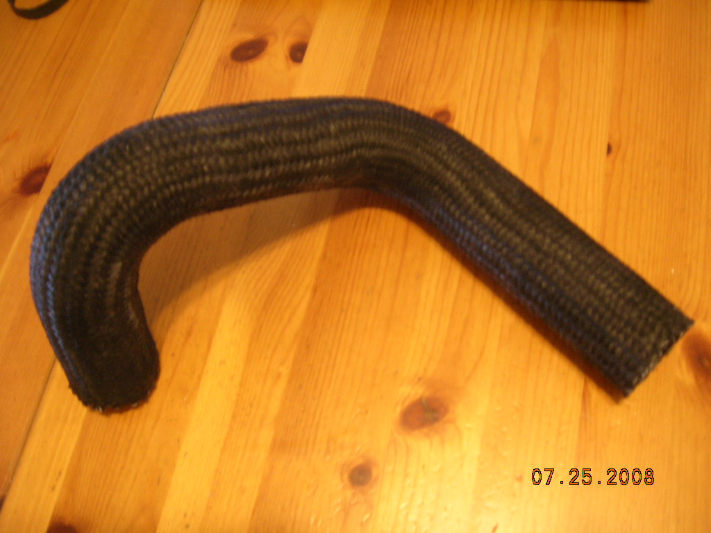

If you shop around, and spend some time, you could made something like this, too. They are all hand braided and hoses inside are Nissan Genuine parts.
Radiator upper hose, lower hose, heater hoses, bypass hose. These are my test units with 4 different pattern(materials) and see how well they work and how long they last. If you could try them, why spend $150-200 for a new old stock hoses that are so expensive and not very dependable in a long run.

Excuse me for not understanding, but how are you making these formed, cloth covered, hoses? Did I miss something in a previous post or other thread?
Dennis
I'm guessing a little glue to hold on the various sleeving types, and a stiff wire on the inside to hold the shape of the hose. Nice look, but a PITA to make and maintain. That said, this seems like an affordable alternative to the stock unobtainium.

Well, as I mentioned, I am trying different materials on a car to see how they function and how long they last: Plastic, steel, fiber, and cloth. To cover the hose and place them in right position, I have tried sylicone glue. Please remember these hoses expand once they get hot water running through. Also the hose tends to carl up at the end specially when you try to slip it on the inlet. In this picture, I have a piece of shrink tube in small width just in case. So I am still in reseach and development.

Thanks, that sort of clears it up for me. Keep us posted on your experiments.

I did make fake of a master vac hose using OEM gastank hose.
Please refer #154,
http://www.classiczcars.com/forums/showthread.php?t=25575&highlight=kats&page=7
Brass rod is inside and keeping its shape,no-problem for its operation.
