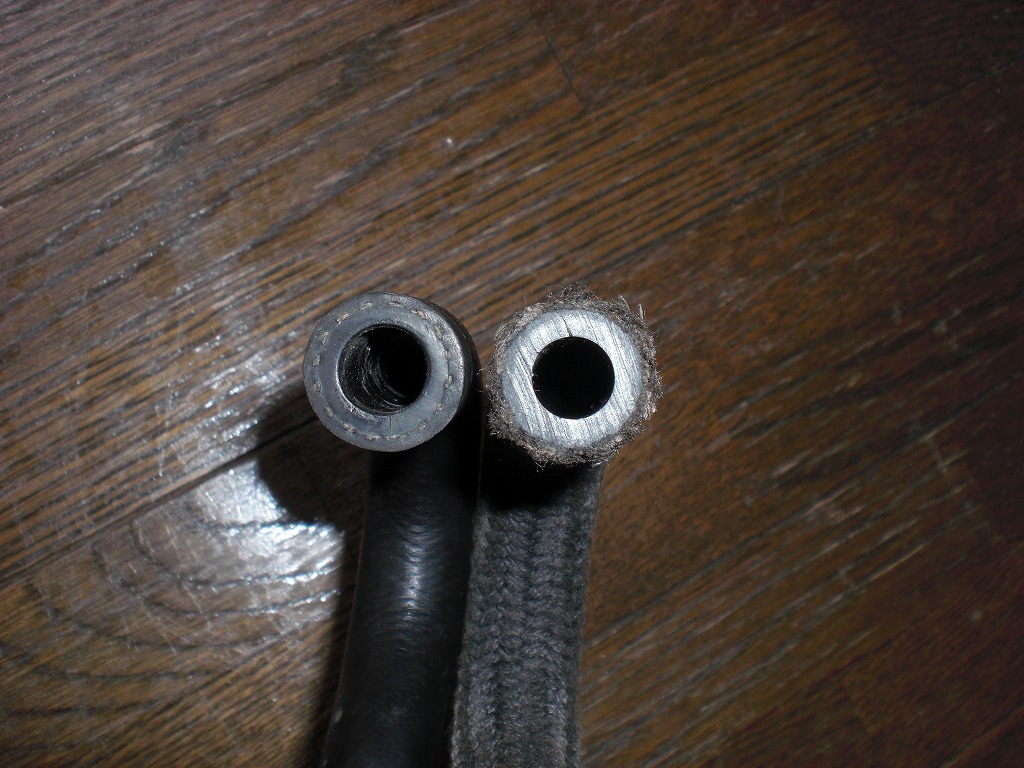

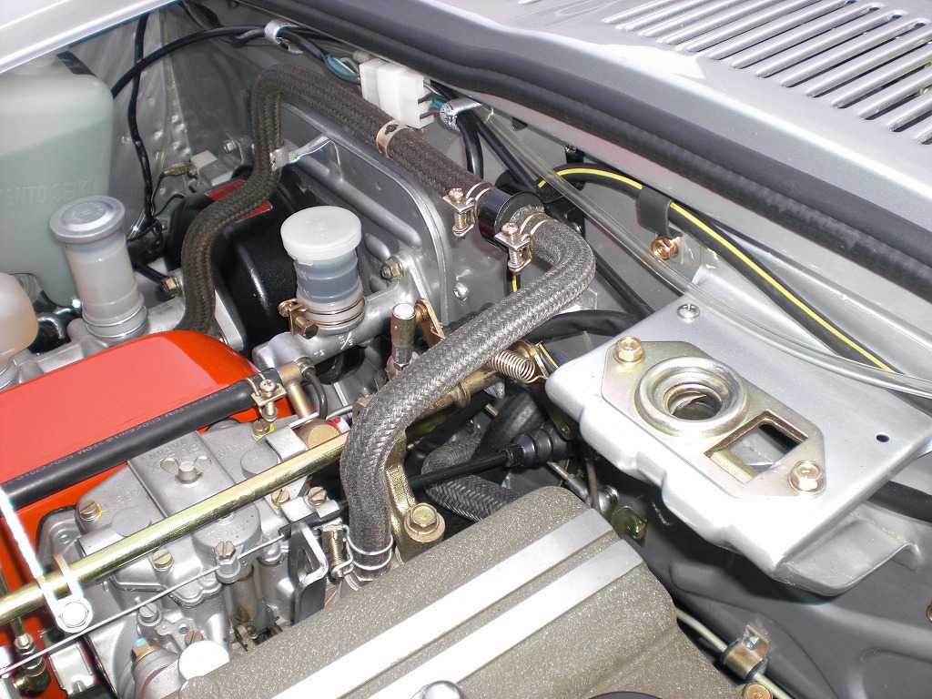

This is my fake vac hose, almost 2 years passed and added 10000 miles since then.
The last picture is for comparison, the left one is an OEM vac hose(no-cloth braided) , the right one is OEM FUEL hose(Gas tank to reservoir) which is used for fake vac hose.
kats
