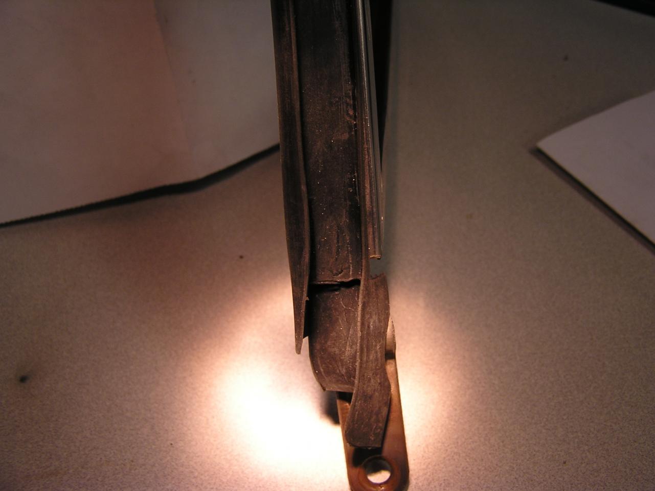

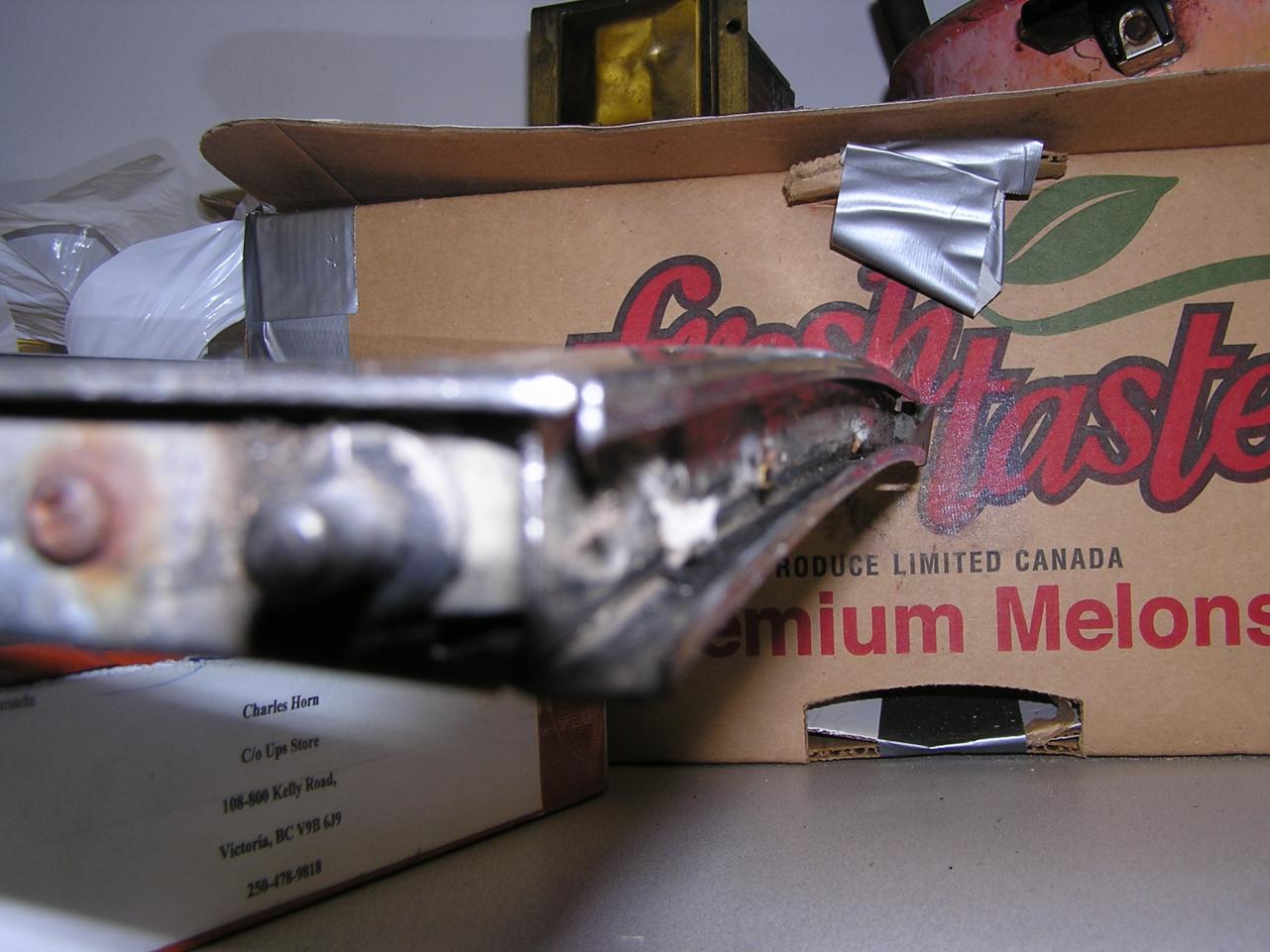

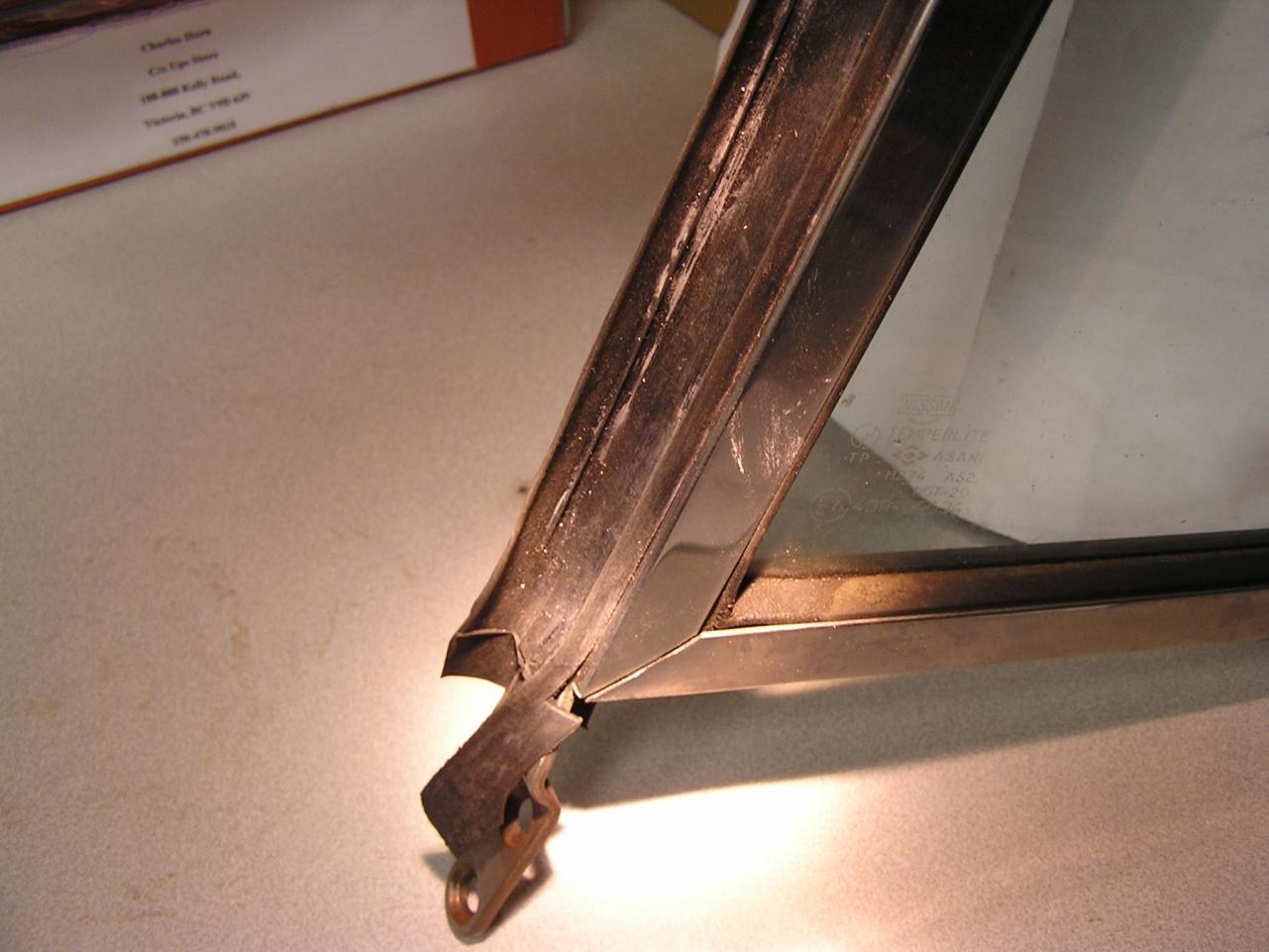

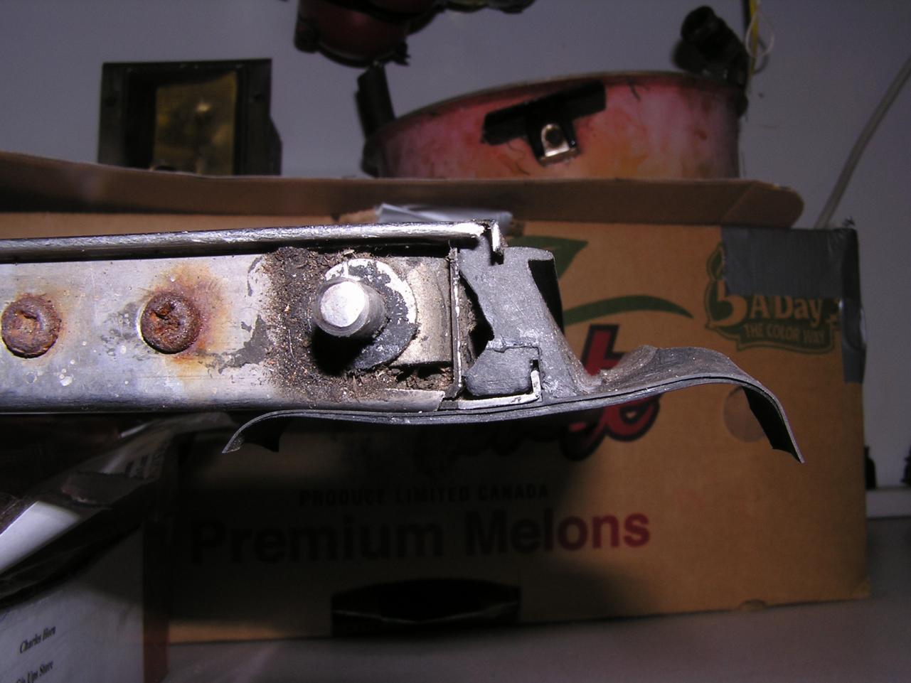

I have these seals for my 74 260 2/2. when i ordered from MSA they were listed as the same part number for the 240. Turns out BD sent me the wrong part so i got them from Charlie Osborne. But, mine don't 'screw in', they slide down a channel in the front of the 1/4 window. I have since decided to replace the whole seal, which now comes as a one piece, so I have those two surplus single seals and am happy to send them to you if they fit.
here are some pics: is your 240 the same?

The have 2 screw hols at the top close together (like in your pictire) and one in the centre and a third further down. But the window does not have the screws there, so I figure I would need to glue them in as well as fix them at the top.
I have not fitted them yet as one side is a very tight fit between the door and quarter window.
