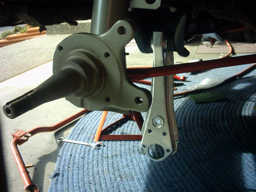

On each torsion rod, there should be a large washer -large rubber bushing - then the body hole (attached to the frame) then rubber again and then another large washer, followed by a small washer and a large nut.
The pics below will show how it should sit. The first is of the right side and the second is of the drivers side. The control arms should sit forward in the center crossmember.

My money is one the T/C rod (red in the pictures above). That's the easiest way to move your wheel forward or back. With that tire size, he must have moved it a lot! He should not touch that T/C rod when doing an alignment. If you have a stock suspension in the car, the only adjustment is toe-in toe-out. You need a camber kit to make any changes there.

Can you get under your car and take some pictures of everything? If you can, post pictures of where the control arm attaches to the crossmember, where the compression arm attaches to the body and where the compression arm attaches to the control arm near the wheel.
Some good pictures showing how it should go together can be found at:
http://atlanticz.ca/zclub/techtips/suspension/comprod/index.html
*note that there are some pictures showing some shims - if this is where your friend put washers then this would be the first place to start in fixing your problem.
