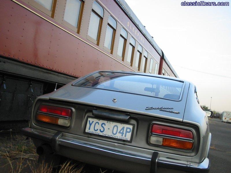

Very well thankyou Enrique! Here is a recent picture taken by the new owner. They really came out very nice, and for anyone not doing a concourse restoration I'd recommend painting the grey plastic backing pieces white!
