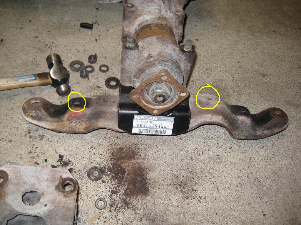

I have my car up on stands and was removing the diff and half-shafts on the weekend. I knew these bolts would be a problem, I lubed them first, then used a torch and heated them up. The firast one turned a half turn then the head snapped off. All the rest broke off also. I noticed that the P/O must have snapped one off also because one was snapped off before I got to it.

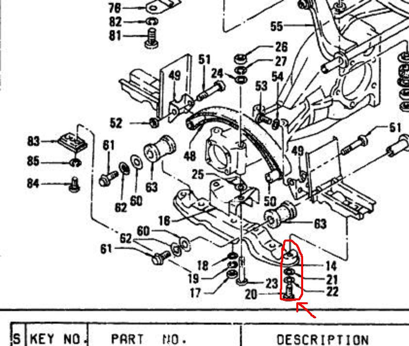

I guess the best way now is to drill/tap it. But I need new bolts. I looked in the fiche and I *think* its #20. It says BOLT HEX M10 x4 (but theres 5 bolt holes?).
Anyone know the exact specs of this bolt so I can get replacements?
I photoshopped my fiche enough to read a part number, it was missing some letters and blurry. I punched part# 08124-03010 into nissanparts.cc and it came back 08124-0301A BOLT.
I guess I can just order them from Nissan. I power washed my half-shafts and diff and discovered the u-joints in them with zerk fittings. There was so much grease and crap caked on them. Now Im going to clean them up, paint them, new bushings, u-joints and as long as I can get the broken bolts out (fingers crossed) I'll be set.
I havn't seen KROIL anywhere here, nor PB Blaster. I have been using anti-seize on things Ive already taken apart and put back together... So far I've been lucky, 2 bolts in the front of the engine cover, removed no problem. 1 head bolt again got it out, now these 4.
If I can get these 4 out (they're pretty important!) I'll consider the whole thing a success. I'll keep you posted.
