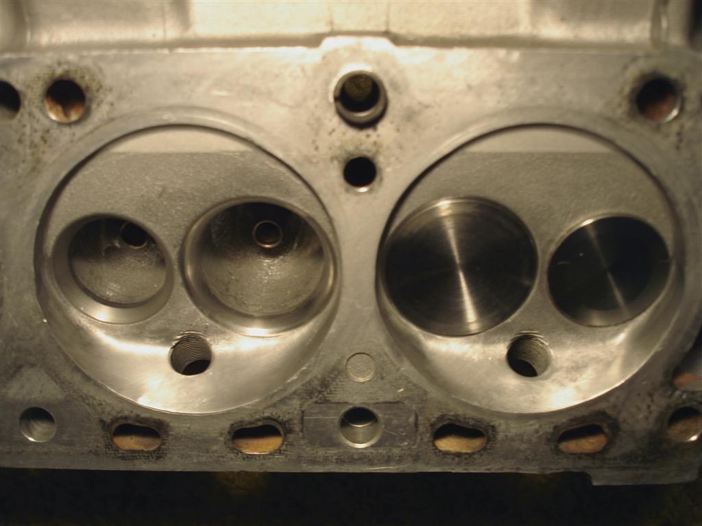

Carl.....Here's a close-up of the P79 head shaved .080 in. You said you wanted to see the combustion chambers. Guy
Hi Guy / Brandon:

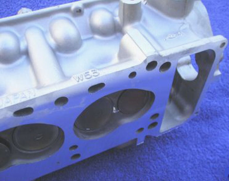

Wow - great pictures. Quite a difference from the E31/E88 chamber design. The quench area is quite flat compared to the more hemispherical design of the earlier heads. Looks like some very fine work there. Very interesting..
I'm going to steal some pictures from you guys for my image files.. This time I'll remember to put names on them...
Early E88 on the Left and late {73/74} on the Right

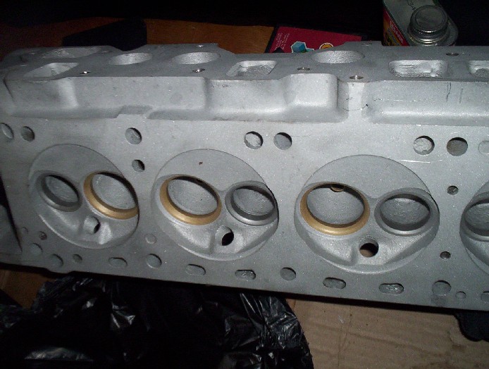

Carl....Yes the P90 and P79 are identical except for exhaust ports and liners in the P79.They boast the best quench of all the heads and according to Doc, allow a better "burn". I believe that they are referred to as the "peanut heads". Guy
Very interesting. I was considering sticking with the P79 on my F54 build as well. I'm almost committed but Rebello feels that the N42 head has the most potential. That said, I'm not looking to take things to the max anway. I don't think they're convinced that the exhaust liners flow as well as the N42 square ports when smoothed out. One reason I'd like to stay with the P79 is so I can use my vintage Clifford 6 into 2 coated round round tube header. It's awfully purty. :)

Rebello knows what they're talking about (obviously)........Here's a good web-site with a wealth of info. He discusses the P79 and what he's found regarding the exhaust liners (he doesn't think they are very restrictive). The headers look great! Good Luck! http://www.datsunzgarage.com/
