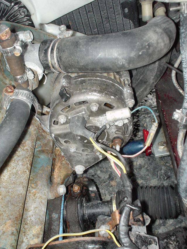

The ground to the alternator? Could you show me a pic?

I took the car to a local shop. After they had looked her over well, they told me they think the ground from the alt has some breakage in it somewhere and they're in the process of locating it.
They said the rest of the wiring looked pretty good, so now it's just a process of finding the break and making a new one.
