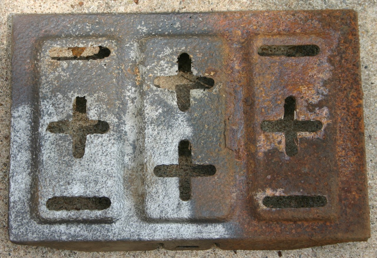

I have a series I car which has a metal tray (it "had" some kind of coating, like rubbery plastic or something), it has I believe it's 6 places in the bottom where there are + shaped openings/holes. Was this OE or some aftermarket piece?
I'm trying to decide if it's worth restoring or scrapping, it's VERY rusty and will require a TON of media blasting to clean up then lots of effort filling in all the rust through. When all that's done I could finaly finish it off with POR15.

Plastic one is the original. What you have is not original. Sulfric acid kills metal, and that is why it is made of plastic.

This is why I was asking, because if the metal was was not even the original then I'd certainly not spend the time restoring it. If it were the original and they are NLA I would.

Well it seems as though the question has been answered...plastic it is and always has been.
Just for the record, since I said I'd post pix of mine here they are. Both of these are after some media blasting on 1/2 of the item (will be very obvious).
