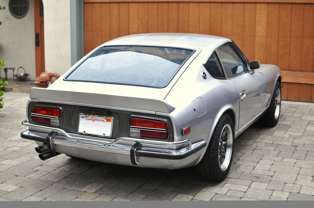

today I realized that my 240Z tail light panel would deserve a refresh. The car is original and I don't want to remove the panel for a complete restoration of this part. Is there any alternatives?
The left side is still a darker grey color but the right side is discolored by the UV and is light grey colored.

1. It's metal.
2. Original color is dark grey (not black as I mistakenly said - thanks Arne).
3. Pop 'em both off (It's two side separate side panels with a gap in the middle that's hidden by the license plate) and paint!

It's actually three separate pieces, both sides and the center with plate mounts. It's also not black, it should be a medium-dark gray, totally flat, no gloss. Lots of threads here on the proper color. It should be removed from the car to prep it properly for new paint.

Call Les at Classic Datsun. He has the custom original color mixed in spray cans and will sell you the correct paint if that is what you are looking for. I purchased two cans when I had my bodywork completed and had my painter matched the color. I still have one can @$25.00 per can but I have put that in storage incase I was to need it in the future.
I would remove all three rear panels, clean them up, light sand, steel wool, prime, and then use correct color paint from Les (three light coats). Your tail light panels will look correct from the factory (or as close as we can get).

If you are not looking for the sorta-rough, stock finish you can use Duplicolor "graphite" color wheel paint. (see pic)
It's pretty close to the original color, (slightly darker), and availale at most auto parts stores.
