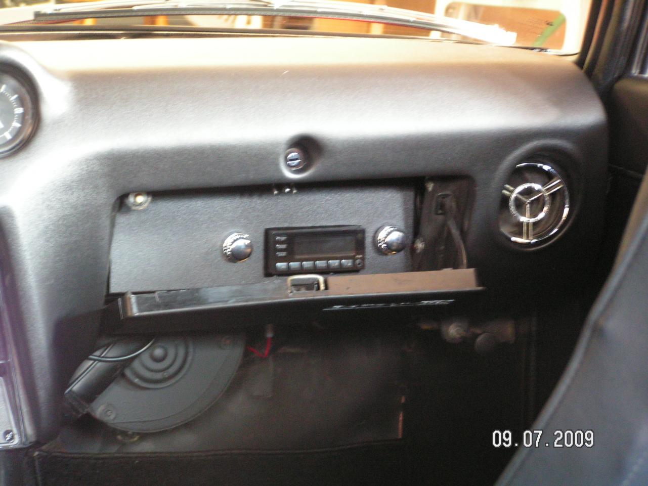

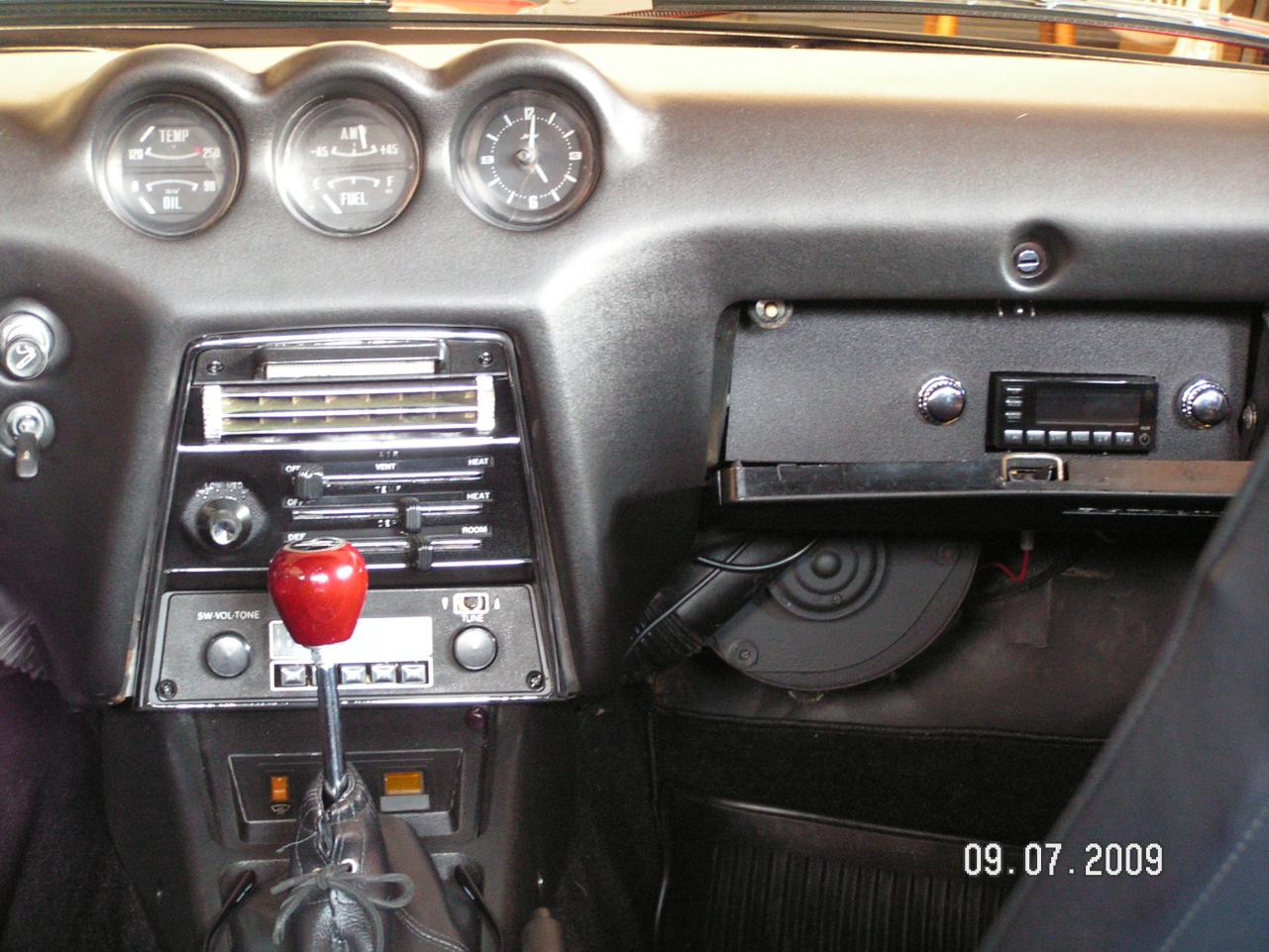

I did leave my original AM/FM in place and fully operational. The Retro Sound One system sounds great. The remote works well. I've got my system in place (I have not finalized the glove box face plate yet). My AM/FM has 10 times better reception and my Ipod had a never ending random song selection. I can get a thumbdrive and download but I kinda like the Ipod and picking the songs or artists that I'm in the mood for. I've got over 200 CD's loaded so I'm good to go!
I am very pleased with the Retro Sound One product and the simplicity of the install. The glove box mounting was a little tricky but sitting in the car you would never know it was there.

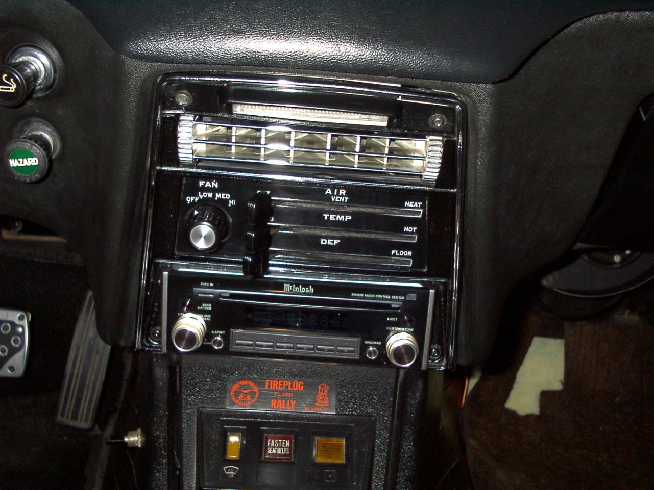

When it came time to replace my radio I was also very much concerned about butchering my center console and after much deliberation decided on this McIntosh unit which I think compliments the dash. As you can see, the pre-amp fits perfectly, the antenna switch was moved to the bottom left center console and the power amp is under the passenger's seat. All six speakers are well integrated and the sound is just simply magnificent. I kept the original radio, of course, and going back to stock would be an easy matter.
