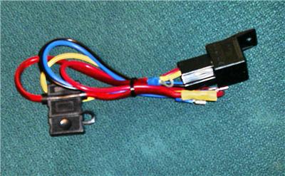

Question: Has anyone installed this Starter Relay Kit; was it easy and did it make your staring more reliable in the Heat of Summer?

Fused power to pin 30 (14 or 12 guage is great) (15 amp fuse should be fine)
ground wire to pin 85
starter wire to pin 86
wire from pin 87 to starter solenoid (14 or 12 guage wire)
easy enough, great power to solenoid, easier on the ignition switch and also allows you to use a low amperage push button switch if you wanna do that kinda thing to your Z.......

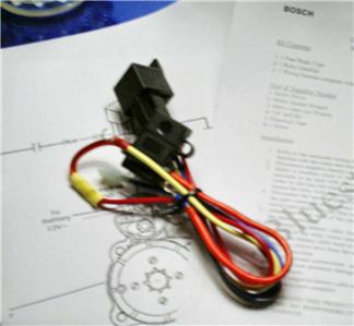

Well I installed this 12v Starter Relay kit. It was pretty easy to do in about 20mins. The challenge for me was getting the wire lengths to my liking such that it integrated nicely into my harness. The Relay and 15amp Fuse fit nicely in my Battery area out of the way.
Tried it today in +85F heat - while running some errands for the 4th of July cookout and it worked superbly! Immediate starting when I turn the key to Start! It's a reall treat and no more worry when I go to a gas station to fill up on a really hot day.
Highly recommended for anyone with a bit of a flakey starting problem in high temperature conditions.
