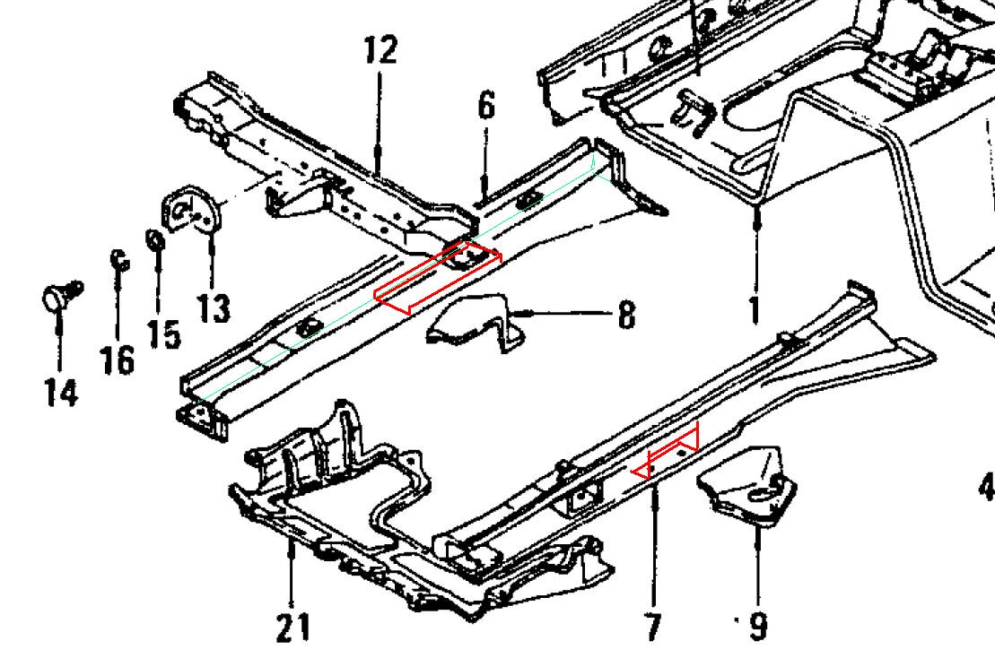

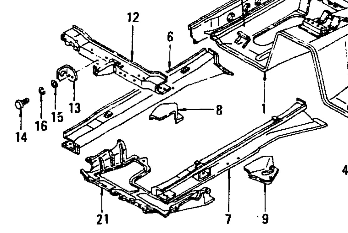

I may be looking at the pictures all wrong - but it seems that your Frame Rail is fine - it is the lower part of the inner-fender, that forms the outside of the "box" to complete the structure of the frame rail - that has rusted away.
I'd certainly clean the rust out of the frame rail itself - and treat it to prevent farther damage. Then I don't see any reason why you could not just cut the inner-fender back to a point where you have solid metal, then weld in a patch.
Replacing the frame rail with a new OEM part - still would not correct the damage to the inner-fender.

The frame rail is compromised, but not to the extent that the inner fender is. It suprsises me that this area isnt built any better.
I have tried to add a 3d's outline of where the damage is. The green line represents the lower outside edge (inner fender bottom). Red = damage....on the passenger side it only creeps up half way. On the inner fender edge it climps ot the top of where the frame rail welds on per carl's diagram. I need to pull off the angle iron to be sure though.

Actually the front frame rails carry very little weight. The weight of the engine is carried by the front cross member to the to the strut and strut tower. Most of the weight of the body on the front suspension is carried by the upper fender horns. The front frame rails main load, other than at the strut towers - is fore/aft.
So strength is needed primarily in the area between the front frame rail and the strut tower.
Again, I see no reason a properly welded in sheet-metal section, to replace the original - would pose any problem at all. I wouldn't recommend a butt joint - but rather a piece of metal welded inside the frame rail where you have solid metal - overlapped with the new exterior piece. That way you would have the needed strength with acceptable cosmetics. Just be sure to tie the frame rail to the strut tower - by fixing the inner-fender.
