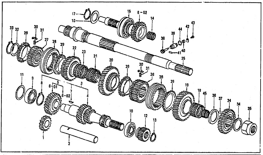

Sorry if this has been covered already but I didn't have much luck with a search. I seem to remember posts elsewhere which stated the mainshaft nuts were NLA from Nissan. Is this true, and if so, is there another source for them? If not, can anyone provide a Nissasn p/n? My particular app will be for a F4W71B, I believe it threads the opposite of the later model trans, but in which direction is unknown.

resurrecting old topic - same problem - need source for RH mainshaft nut for 5-speed
·  32354-E9804   ·  Part: NUT HEX   ·  Replaces: 32354-E9800, 32354-E9802
