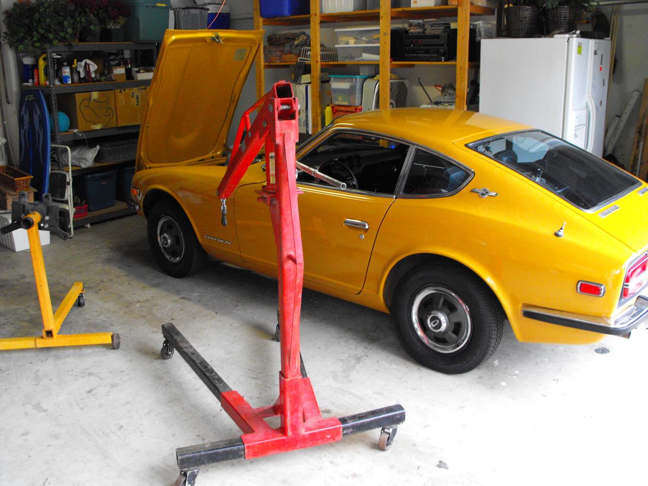

Well, we (my son and I) got the engine block out smoothly. As soon as it was out, we began pulling parts off of it to prep for paint. We stripped it down to a short block. After cleaning the block (wire wheel and lacuer thinner primarily) We wiped it down and I applied several coats of the blue engine block paint. It looks very nice! Will apply a couple more coats later.

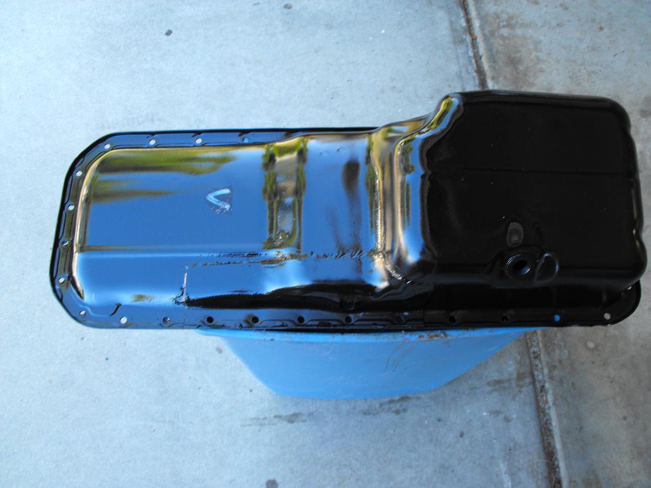

I do have one question though. What is the color of the oil pan? Mine is complete chaos. There is black over the blue and prominent weld marks on the outside. The is also a nice white quality V mark on the black portion on the bottom that I would like to keep. I am leaning toward black for the entire thing. I would like to tape over the quality 'V' and leave it on the pan.

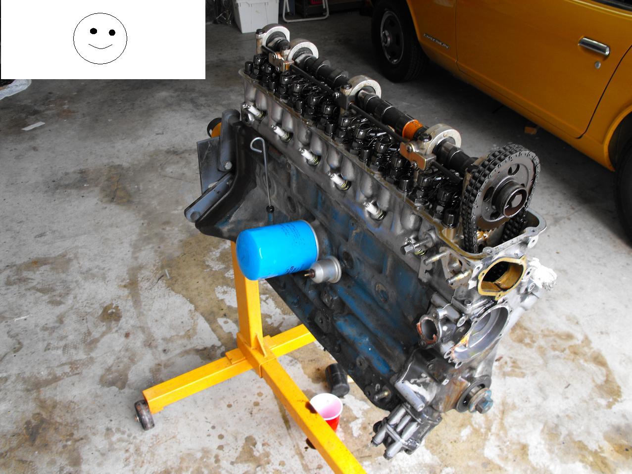

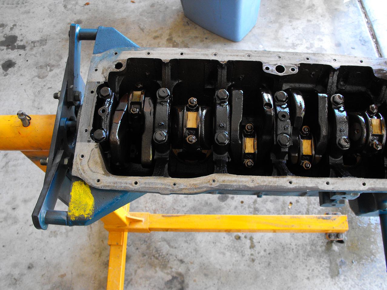

The cylinders look great, so I will not be doing anything with the pistons or crank. The cylinders actually have the original cross-hatching on them still. I was happy to see that. Not much carbon on top of the pistons either. We cleaned that off and taped to the top front and bottom before paint.
We did have one glitch. Broke one of the head bolts off in the block. The bolt broke near the head so I have some body to work with. I put several doses of liquid wrench on (it worked for the smog rails). Will add more and work on this after the paint is done. Hopefully this comes out OK. I have learned not to rush this, let the solvent do its job.
I originally did not want to take the head off, but had a very minor leak near the back (passenger side) between the head and the block. Also, it will be easier to clean and paint this way. Also allowed me to check the cylinders.

What's your engine serial #, Rich? As you describe the oil pan, it sounds like you have an early one. Check your head stud lengths - you might have three different sizes. Those engines were painted after assembly and you will notice blue and black overspray on various parts. Blue overspray on the aluminum head and front timing cover. Blue overspray on a black oil pan and maybe some black overspray on the block from the oil pan and engine mounts. I put my engine back together with the overspray as it was originally painted. Some people prefer the clean look. The weld marks on your oil pan signify an early engine; unique to the early cars. A damper plate was welded on to the oil pans because of vibration. I would like to see pictures of the V!

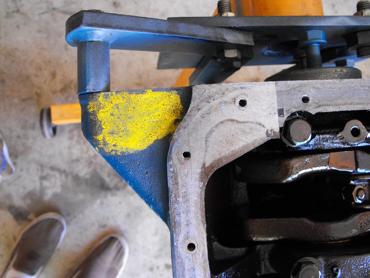

The engine serial number is 005353. I re-painted the block Nissan blue, but taped over the yellow inspection 'blob' so it will remain. I also left the engine serial number unpainted and will put a clear coat over it. I will get you a pic of the oil pan later today with the inspection 'V'. I will see what condition the pan is in and see if just a clean will be sufficient. Maybe just some touch up. It reminds me of a 'tie dye' 70's t-shirt.

I took a couple pics of the inspection marks; one on the engine and one on the oil pan. I decided to leave them because I thought they were pretty cool. Plus they are both on the underside of the engine so not very visible.
Was cleaning parts last night and ran across everything you noted above. It's really very amusing to look this stuff over. There is blue paint on the head, intake manifold, timing chain, cover and oil pan. I have one motor mount that is mostly black and one that is mostly blue. Among this there are the numerous paint runs on the (mostly) blue block. Very random and creative.
I am trying to imagine the scenario's in which a paint job can turn out this bad on the assembly line. My two main thoughts are that the paint guys supervisor gave him 15 seconds to paint the engines, or they were employing children, or drunks (but not drunk children). Anyway, I posted a couple of the inspection marks which will remain.
