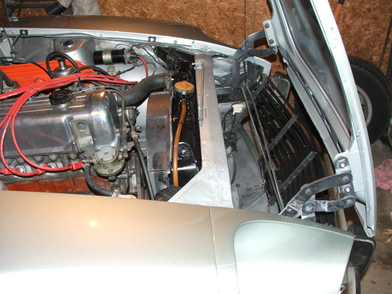

February 4, 201213 yr comment_379702 I have a 280z rad in my 72 240z I found a cowl at a swap meet for 20 bucks. Solved my cooling issues completely. Casey Link to comment https://www.classiczcars.com/forums/topic/32298-fan-shrouds/#findComment-379702 Share on other sites More sharing options...
February 4, 201213 yr comment_379730 Step number one is to pull your radiator and have it rodded and boiled. Give it a good paint job (except for the fins). That is usually the main problem with a car running a little warm or hot. It's amazing how much sludge can be in your water jackets in your engine. A true flush may help also. Once you got the water moving freely in your engine you may decide against the shroud. I installed on for looks more than function. It really did not drop my running temp much at all but I had already accomplished the above to-do list. You may want to do some searches on the topic and get some other folks thought process on that. Keep us posted! Link to comment https://www.classiczcars.com/forums/topic/32298-fan-shrouds/#findComment-379730 Share on other sites More sharing options...
