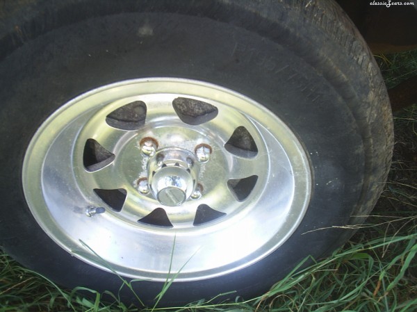

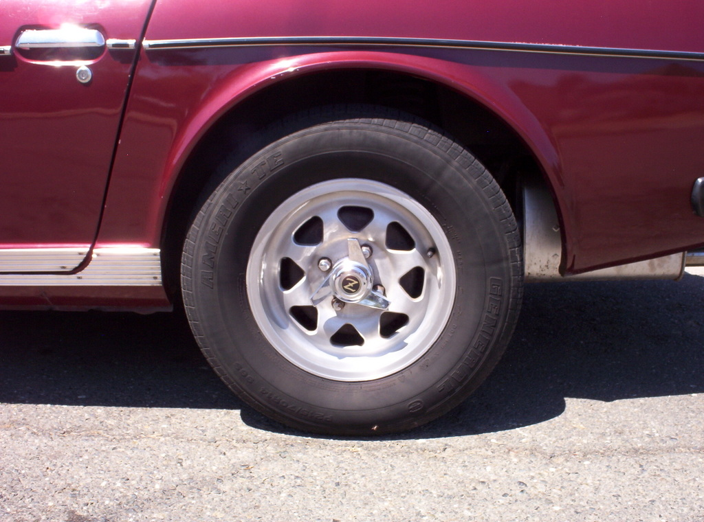

I'm trying to get my Peformance Specialteis rims remade in a 15x7 front and
16x7.5 in the rear to fit a Big brake conversion kit.
These are mine now, in 14 inch size.
And these are a supossed American Racing version.
Just trying to find a shop so I can get the vintage look with newer brakes.
