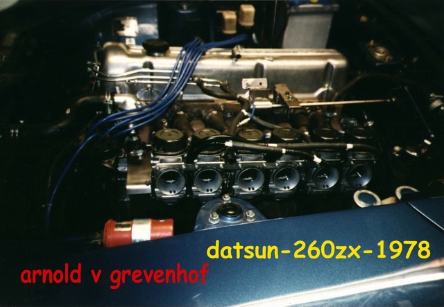

Did it already. One of our members had 6 carbs from a GPX 750 bike on his engine. He wrote in 1999! in our magazine "he had trouble with backfire at 3000rpm.He tried big and smaller needles but at that time nothing worked” end of story. :(
You want me to check this up?
your are lucky I saved all pictures from our magazines

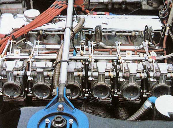

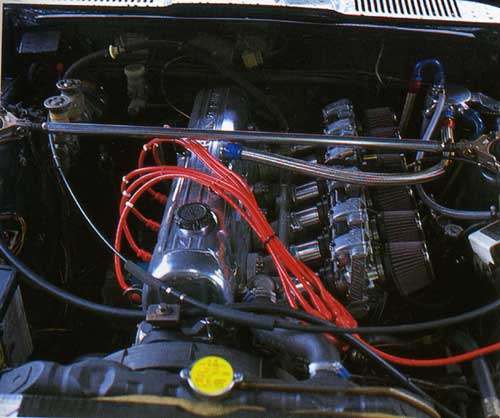

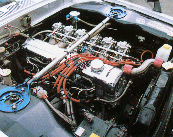

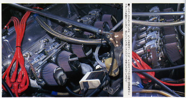

Hi Fred, Guus, 2Many, ozlime, beandip and everyone,
Like so many things, its been done in Japan before. You used to be able to buy a kit for quite a lot of Japanese "Classic" cars - although it was pretty expensive.
The FCR carbs cured all the tuning problems that Guus mentions, and I believe that they work quite well.
The following pictures are of C10 and C110 Skylines with the 6 FCR's on L28 engines. Sorry I could not dig up any S30-series Z pictures with the FCR's.
Alan T.
