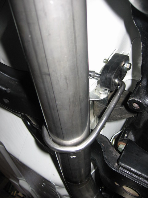

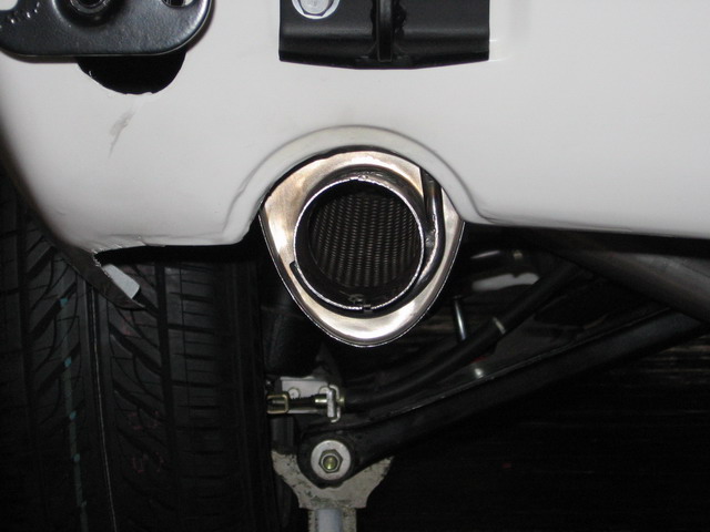

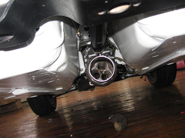

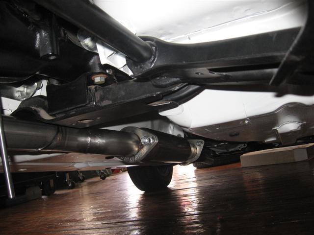

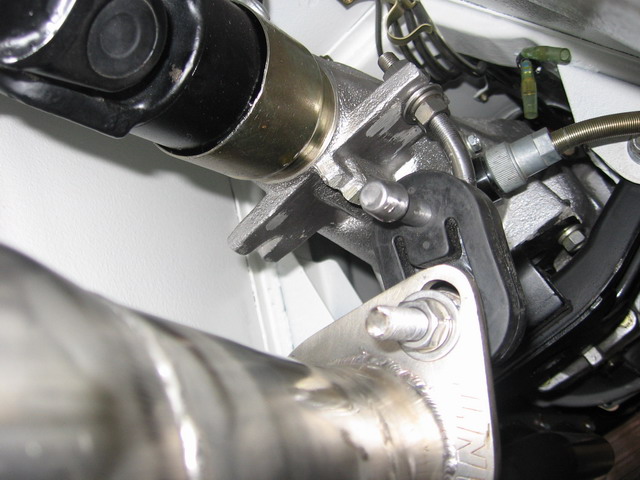

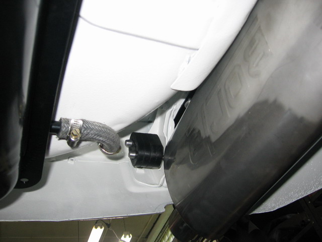

I had a 2.25" dia. S.S. system with a resonator, muffler and flanged connections fabricated from Borla components. In comparison, US$800.00 seems reasonable.
I agree with Arne's suggestion on a user fabricated head pipe/header connection. Other suggestions include a resonator option for those tat want a little quieter system and wire/rubber isolator hangers as used in current exhaust systems.
