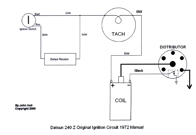

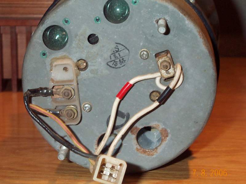

Welcome to this valuable site and thanks for inquiring on a stock Tach Repair approach. I've not be able to locate any schematics for a 240z Stock positive trigger tach for my Sept 1972 built car. There are several styles of Tach Hookups and I'm sure your 280z is a - negative trigger tach off the coil.
Notice my attachments on how the 240z Tach plugs into the harness and the schematic of how it's tied into the ignition circuit. Mine is a 4 wire hookup BUT with 2 of the wires being an inductive loop to complete the ignition circuit (not functional to the tach itself) - so really for the 240z Tach it only has 2 wires - Orange (positive trigger) and Black (Gnd).
