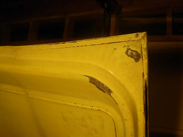

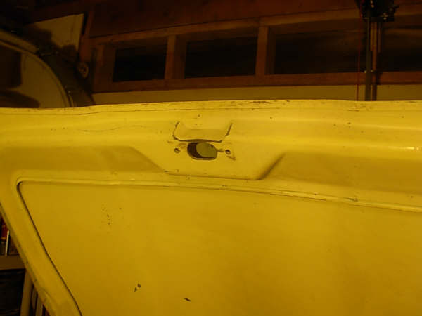

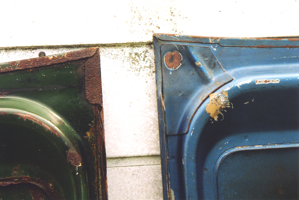

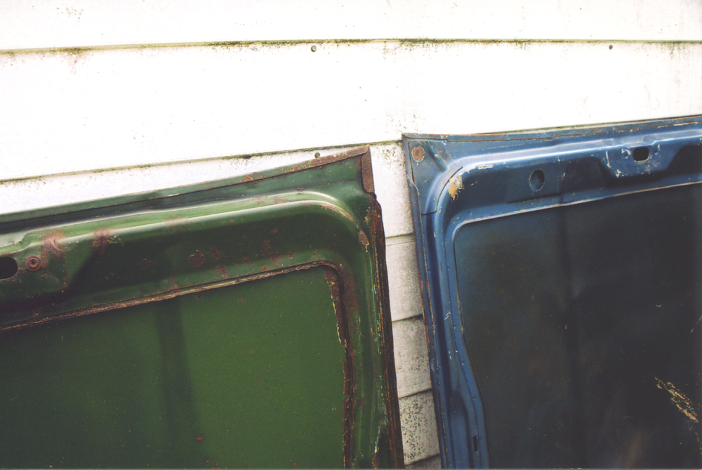

No, I don't think the search tool recognizes 'quoting'. It takes a while to find exactly what you're looking for and it can be a little aggrivating. But kats had a big dicussion about three (I think) different steel pressings for the inside of the hood. The hood is made up of several layers of stamped metal shapes folded over each other and spot welded together. Obviously, the later style with the gussets is stronger. I should weigh them and see what the difference is.
The next big difference is in the rail for the hood latch. The later style has holes stamped in the metal and the pressing around the latch mount is smaller. Between my two really early hoods,it is difficult to see, the way the metal is folded is different between the yellow hood and the green hood. The green hood has a tab that folds over to form the side rail of the hood. The yellow one just has a solid fold all along each side of the hood.
