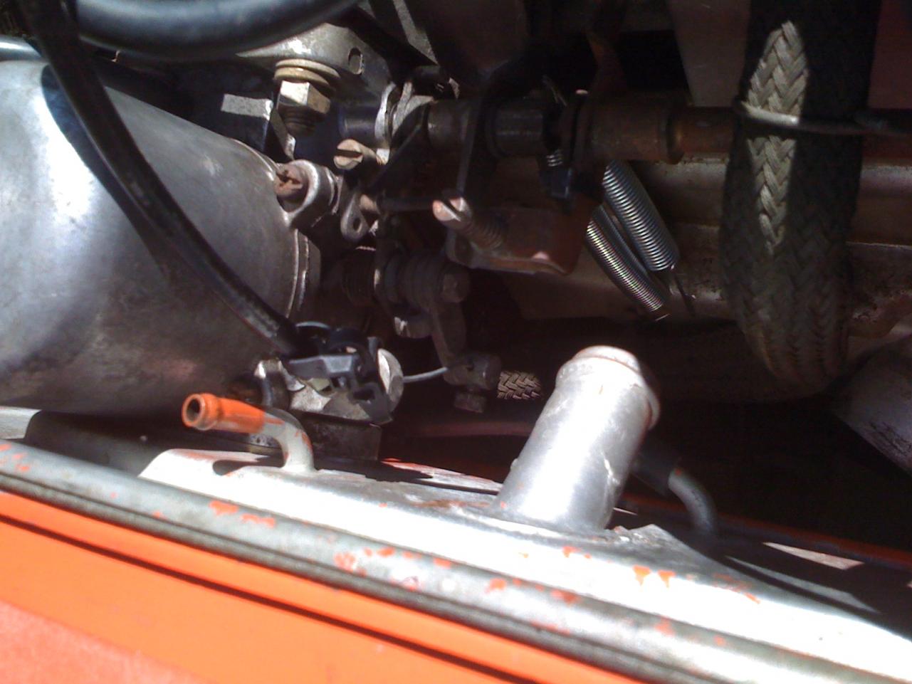

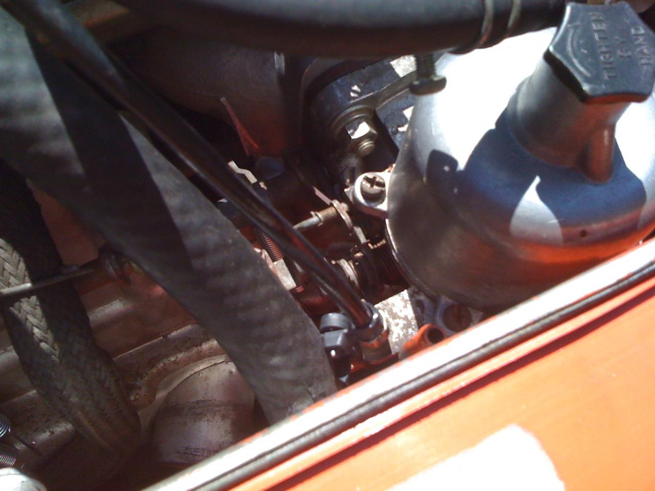

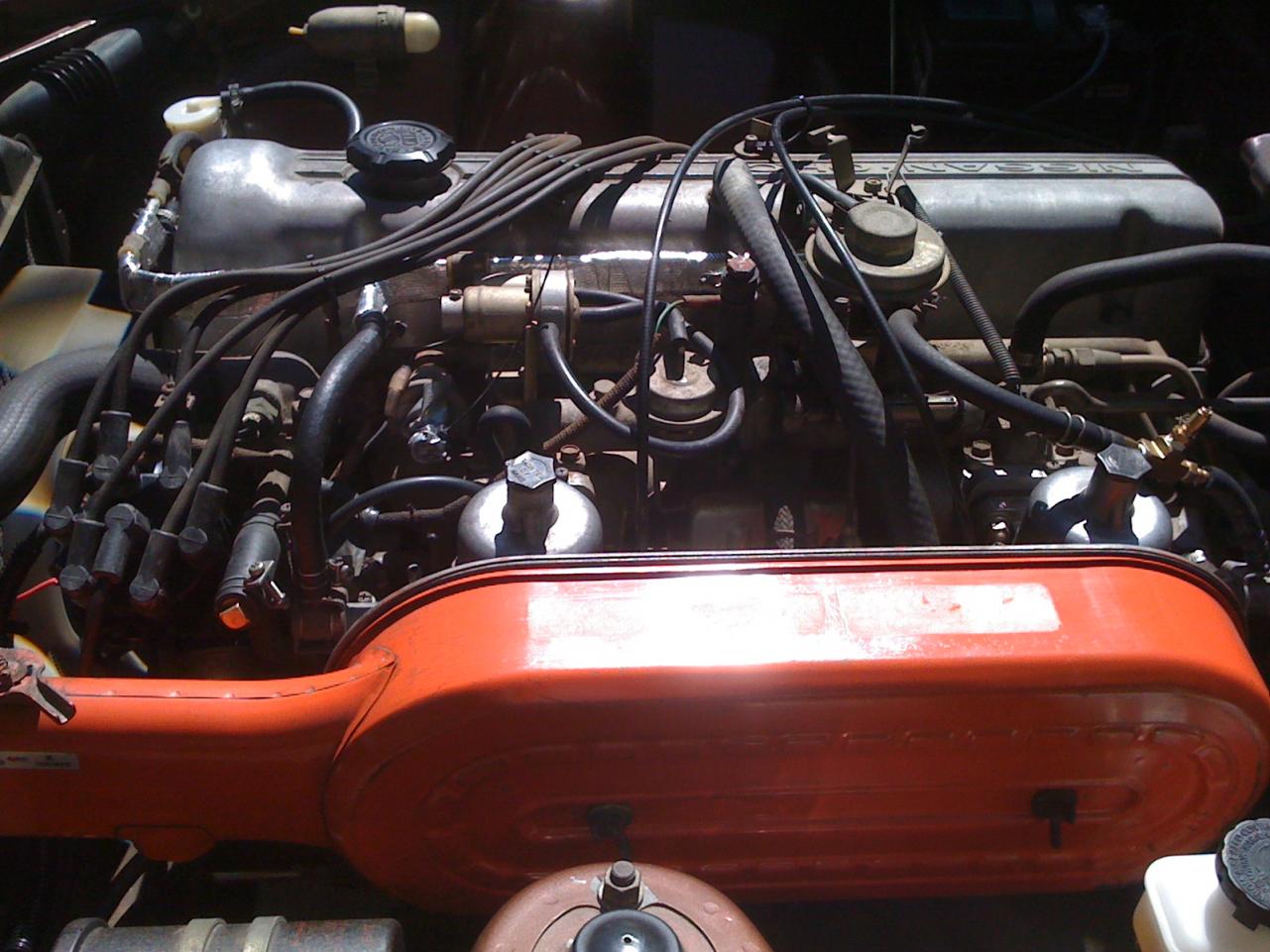

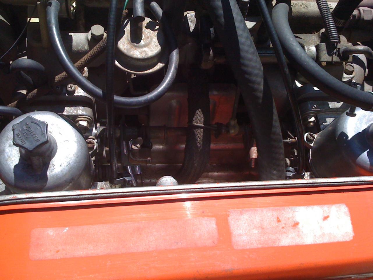

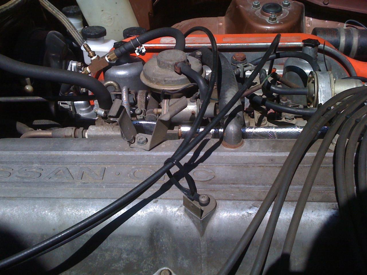

I'm not sure if these will help you but I snapped some pictures with my iphone today. You can see the hoop I was referring to in the pics with the choke cables.
For the carb's I secured the tie around the cable sheath and then threaded the other one through the loop and around the cable on the underside. Like I said, not ideal, but it will get you there while you work on a better solution. I also had to snip off the little clamped end on the cable so it would slide through mount and the rubber accordion as well. Not sure if modifying them like that will bother you. Do not cut the crimp on the cable sheath if you want this to work.
When I swap to headers, I'll clean the engine bay a little more, I have an earlier balance tube without the EGR to use with an N36 intake manifold.
hope this helps!
