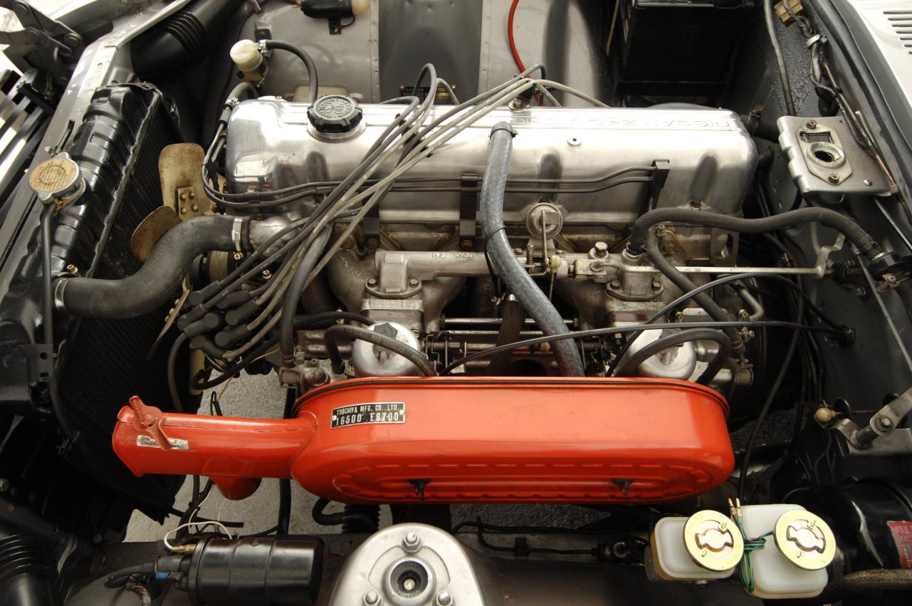

Hi all! I got my first Z, 240 1970! HLS 30 030901. It took a lot of time and effort to bring it over to Russia. Yea, that's where it is now! I guess it is the first and the only one 240Z in the country. Great car, I love it! But here is the thing, the more I read the more questions I get. Some days back I found that my car engine is #L24 144330, which as I understood comes from 1972 or 73 year model. And the hood isn't original and so is the dash. It made me think, what is this car? I will post some photos, maybe someone can help me to figure out which bits of the car comes from which model. It may help me a lot when it comes to ordering parts! As the only place I can get them from is USA.

Looking at the pictures - I can't really tell you much.

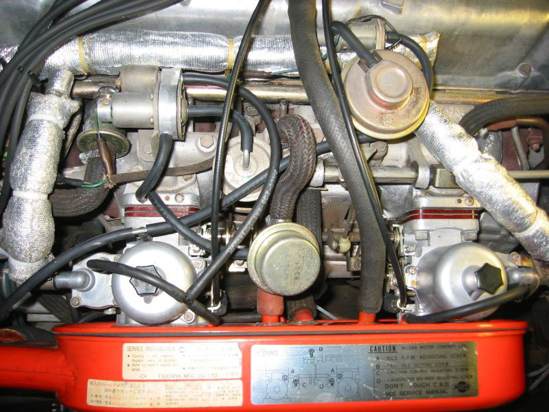

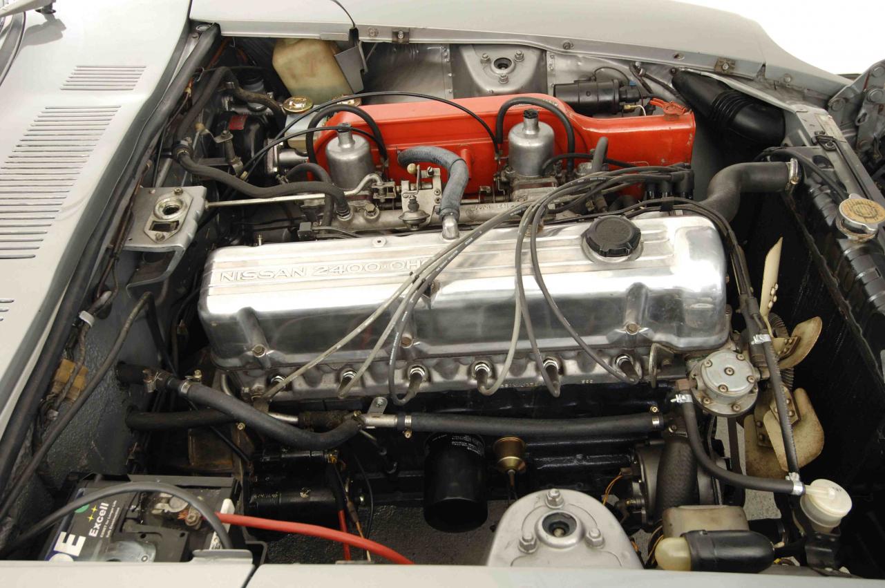

- While the engine block may be from a 1973 240Z, the valve cover is from a Series I car circa 1970. Looks like the S.U. Carb.'s are also from a 70-72 240Z.
- Between the #1 and #2 Spark Plugs - cast into the head below them - there is a letter and number - is is E88 or E31? If it is E88 it is most likely the 73 head, if it is E31 it is most likely the 71 Head.
- That is a non-stock radiator - after market type - but should be fine
- The car has the 70/71 Metal Fan Blade - it would be a good idea to change it out for the newer and lighter weight plastic fan blade. The metal blades are heavy, wear the water pump bushings out and can come off - flying though the radiator or hood. If you can't change it - keep constant attention checking often for any signs of play or movement within the bushing. When worn the fan blade will move up/down when you lift it.

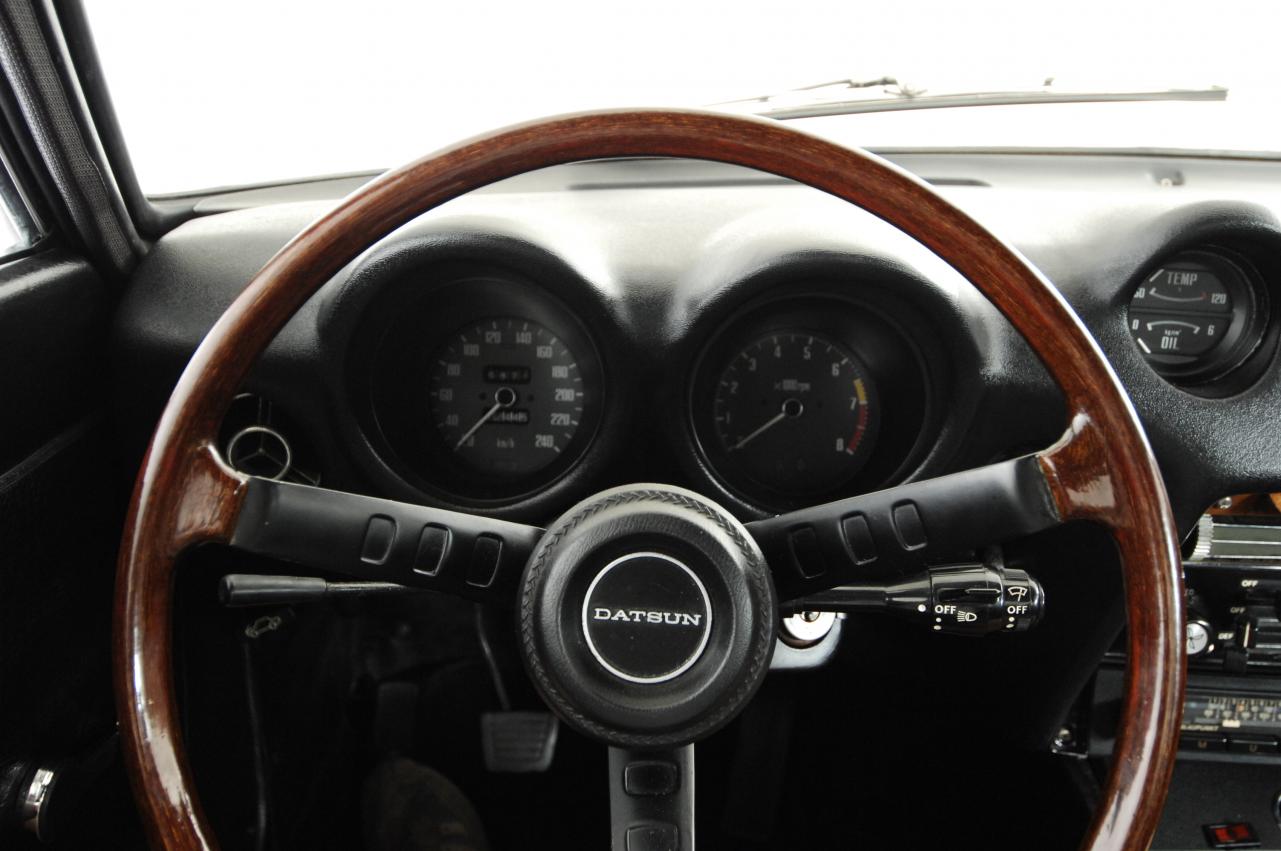

- Steering wheel is from a 70 Model year car
- brake master cylinder looks like an after market replacement
We'll know more as you Post more pictures
Welcome to the Group - tell us more about how you came to buy a 240Z, where it came from etc.
FWIW,
Carl B.
Clearwater/ St. Petersburg Florida

Welcome to the forum and congrats on getting you Z home. You've certainly come to the right place for information. Where did you get your Z from and is that a "euro" style balance tube I see there? I wish I had one of those instead of the spaghetti like mess I have on my California Spec 73' 240Z. LOL
