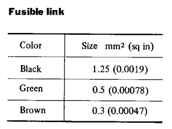

Before installing relays for the headlamps and fog/spot lamps,  I reconsidered the fusible links. Since I think the fusible cartridges are the most appropriate substitute for the fusible links,  I'd start by looking for a cartridge holder that can carry 4 or 6 cartridges.  Is there such a thing?  I think it wouldn't look too blingy in an older car.
BTW-  I still haven't found a reasonable spec for the amperage of the Brown fusible links...
